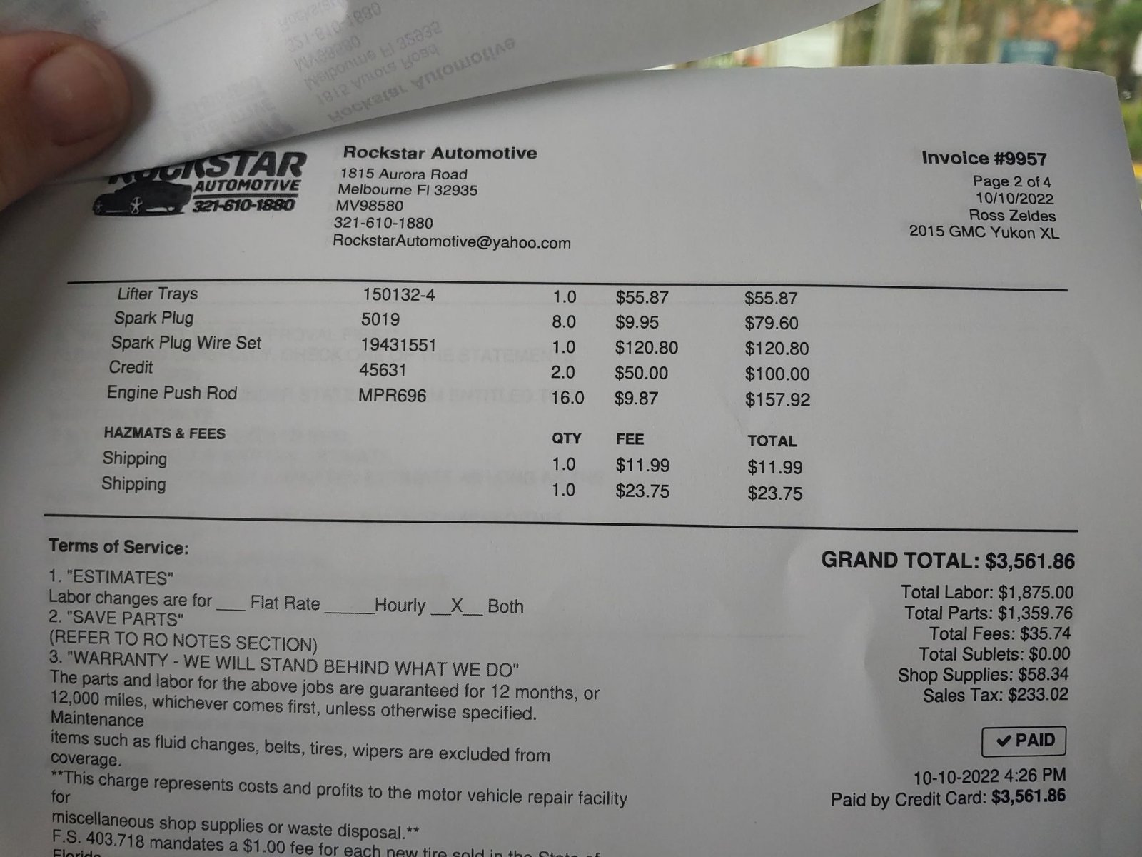

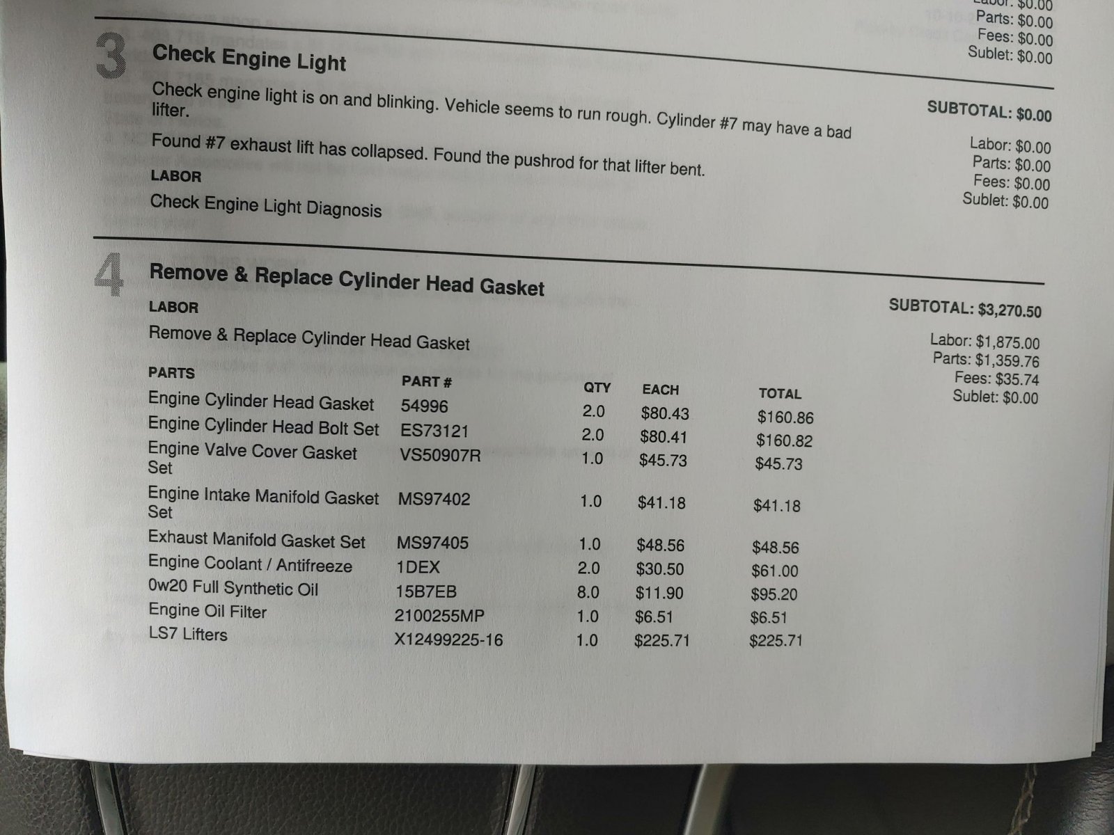

Here are a few photos of the carnage and finished product 59EB6FBA-952B-4A08-BC38-97CB9C4B7E20.jpeg2434DEE2-00EA-49CF-B456-C6A1EE500378.jpeg34A448E2-E7A3-4A74-BD06-16F490EBB145.jpeg

Wow that lifter was toast.
