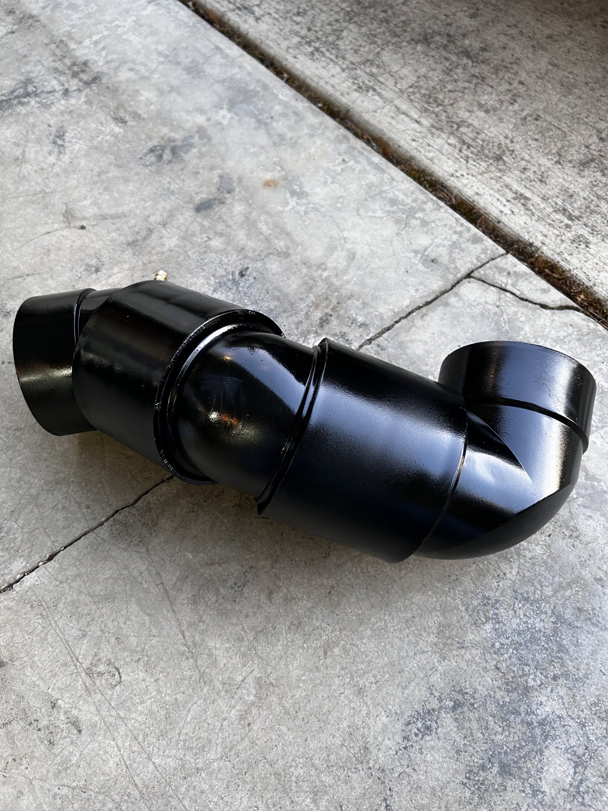

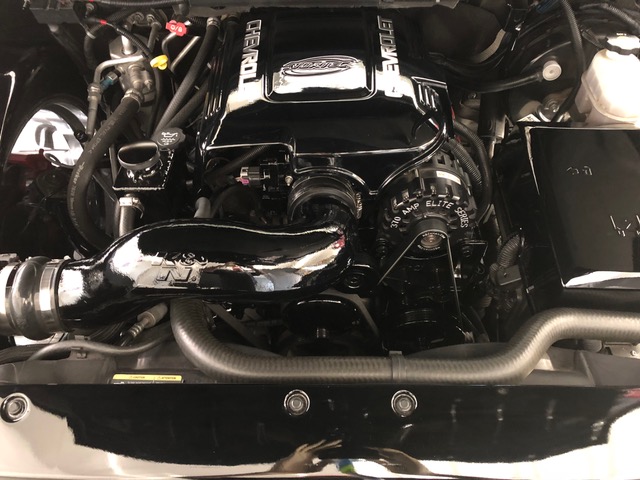

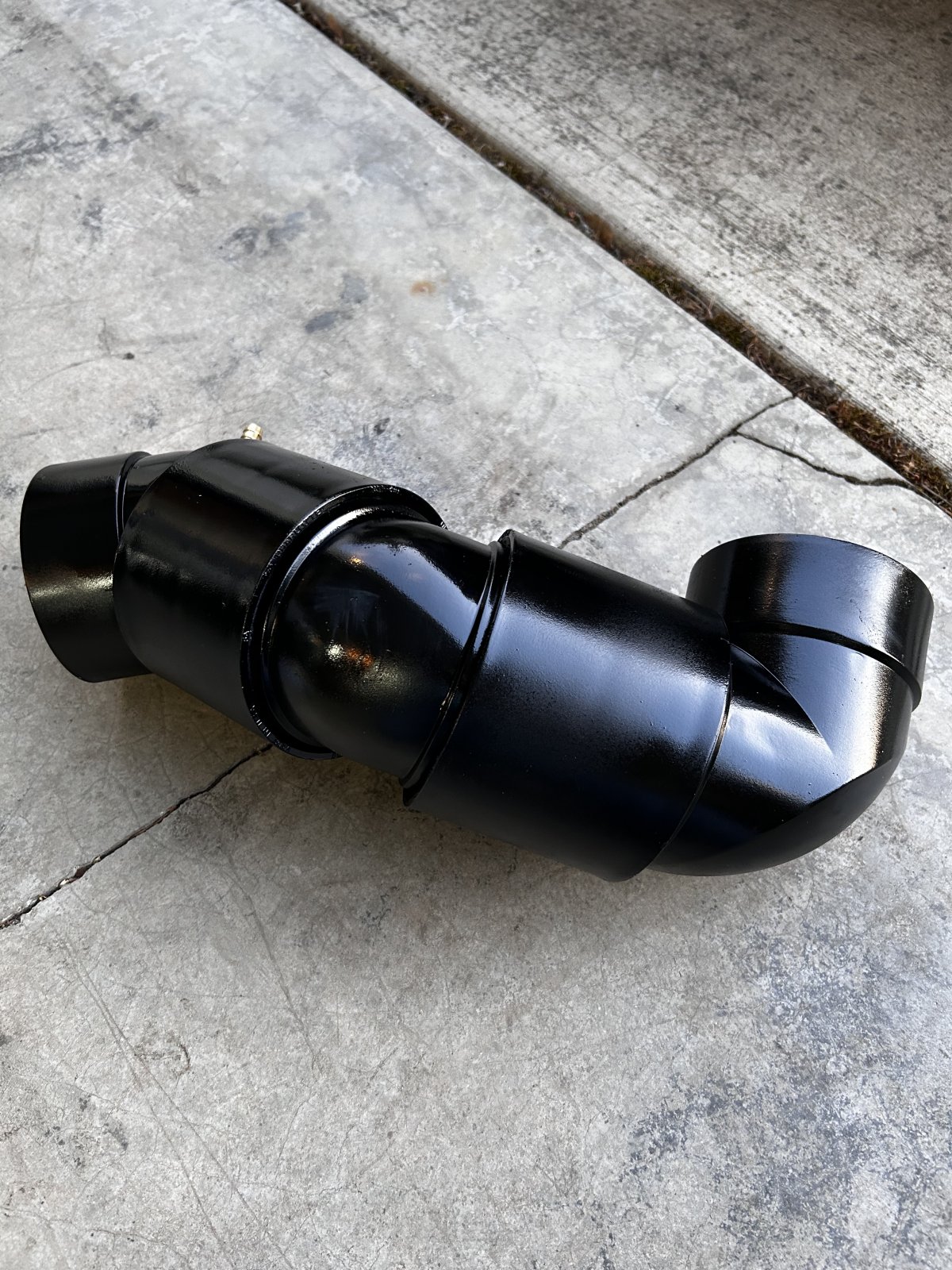

I think his ('09 Tahoe) has an extra 45° fitting in it to aim straight at the factory filter box after arching over the rad hose. If you don't like the flared parts for the slip-fits, you could cut them off and use PVC cement to "butt weld" the joints together, then sand and paint/wrap/dip it.
Found a pic. Sort of a difficult angle to study, but you can get a good idea. It looks to be a 90, two 45s and maybe a foot total of straight pipe to join the elbows together. I would've sanded the lines and text off the flares before painting it:

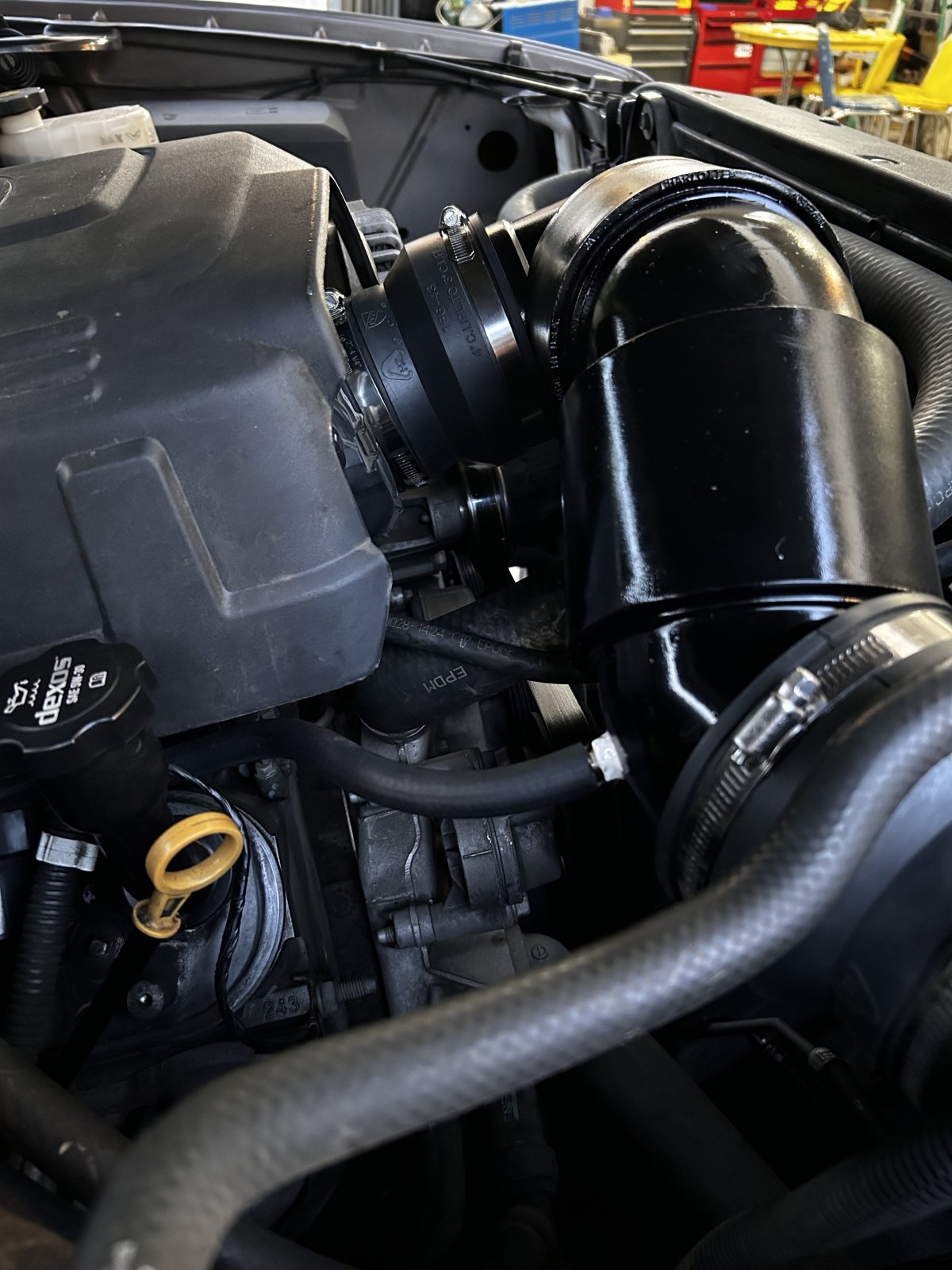

Get some pvc pipe and the 90 elbow from Amazon. That's what I did, I also have the K&N filter.

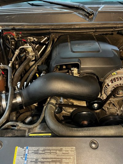

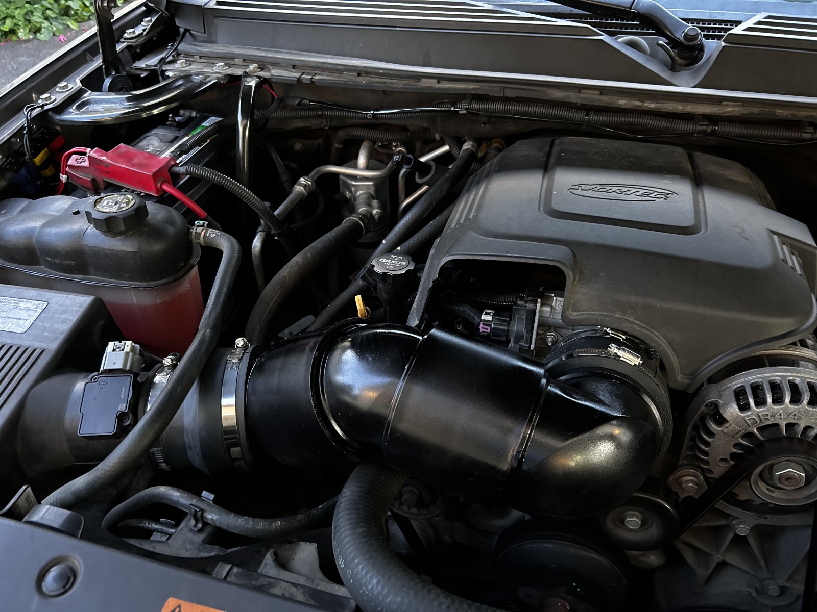

I received it today - went on no problem, looks great. Thank you.
I decided to buy the used one @crownvic31 had for sale. Very reasonable price - judging from the price of those rubber splices in the plumbing section, I don't think I would have saved much/any money by making my own. Pleased with the result. I was a little worried it'd be too noisy up front without the resonator chambers, but I barely noticed. Just at hard throttle can you hear a little more intake noise.
