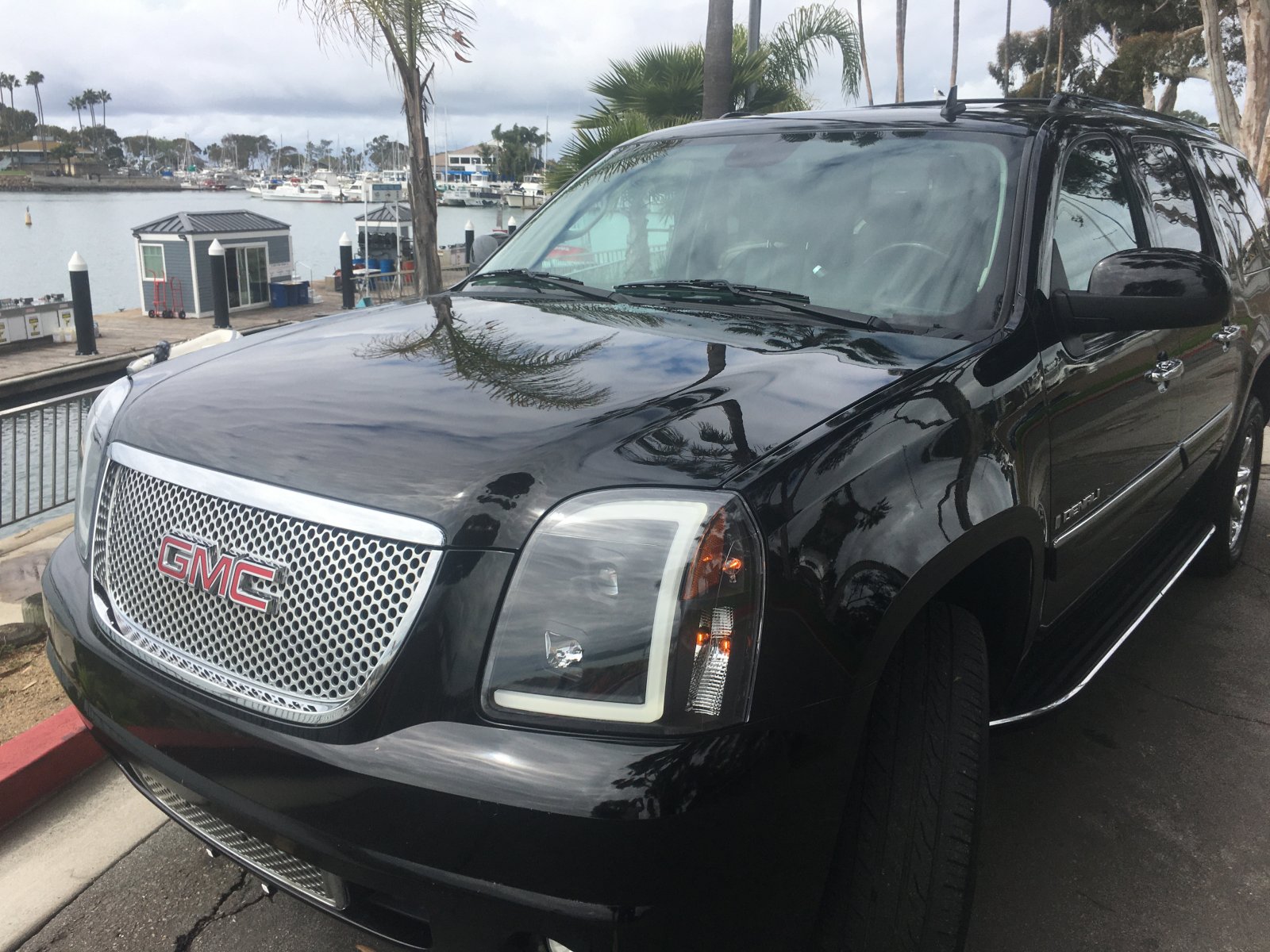

We've owned our Denali XL AWD since ’14. The focus was catching the missed maintenance while under a service contract for the next four years. When something lit the DIC or made a noise, nothing was a surprise anymore. The itch to make changes to the lighting and tires was getting louder. While looking for current market value I noticed SoCal is currently in short supply or 1-3 owner 07-09 NNBS Denali XL but TX is prime and also for Burb’s and ESV.

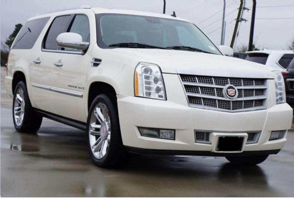

Saw that it was possible to pick up an Eski AWD in TX for the same as a Denali XL AWD in CA. Stumbled on a unicorn 09 Platinum with the Hella designed led headlamps for $15k. Laid out a deposit, called an independent inspector for $169 and the deal was done for $14K. Since '09, $70K fell off in depreciation. We're the 3rd owner of this Eski @ 130 clicks. On the Denali, we're the 2nd owner @ 140 clicks. In six years we put 40K mi on the Denali. It made sense to swap the vehicles, there's no way I could of pulled off adding every feature and option a Platinum is spec'd with.
The Denali is being sold to a friend who I promised would get 1st dibs when the day came. Monday it's getting the roof painted to cure GM’s famous black paint clear coat failure, then a full detail. Once it’s complete, I’ll post both of em up like an old bar pic for Dewar’s.

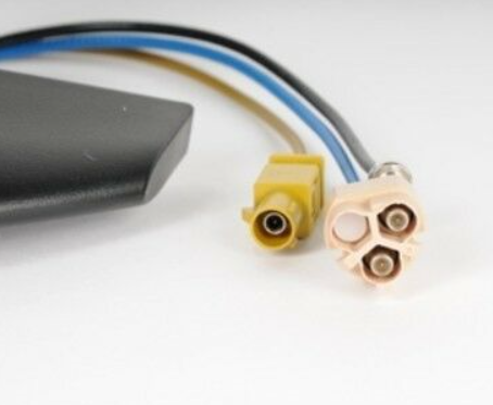

The cure to the bad signal to XM is going to be the antenna. There's three different versions that have one, two or three harness plugs. I'm pretty sure that the 09 & 10 NNBS trucks got antenna with three plugs because none of the OnStar, GPS, Cell, XM or diversity antenna wires had been combined yet. The diversity antenna is in the passenger side cargo glass that looks like defrost laminate wires.
Not sure which harness connector goes on our 09 Esky # 25815079 (above)
Or this version # 25814089 (above). I'm putting my money on this one.
