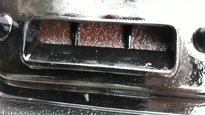

And as promised, here are photos of the filter:

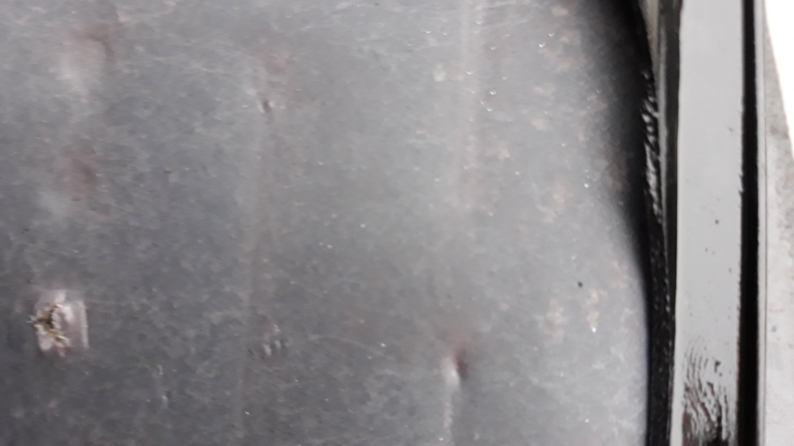

Very clean with some shiny flakes of metal (presumably aluminum) in the filter. The magnet was full of course, no chunks or large flakes of metal. We forgot to take a photo before cleaning it. We replaced the transmission oil pan gasket with a new one. The original stuck to the pan and got misshaped during removal.

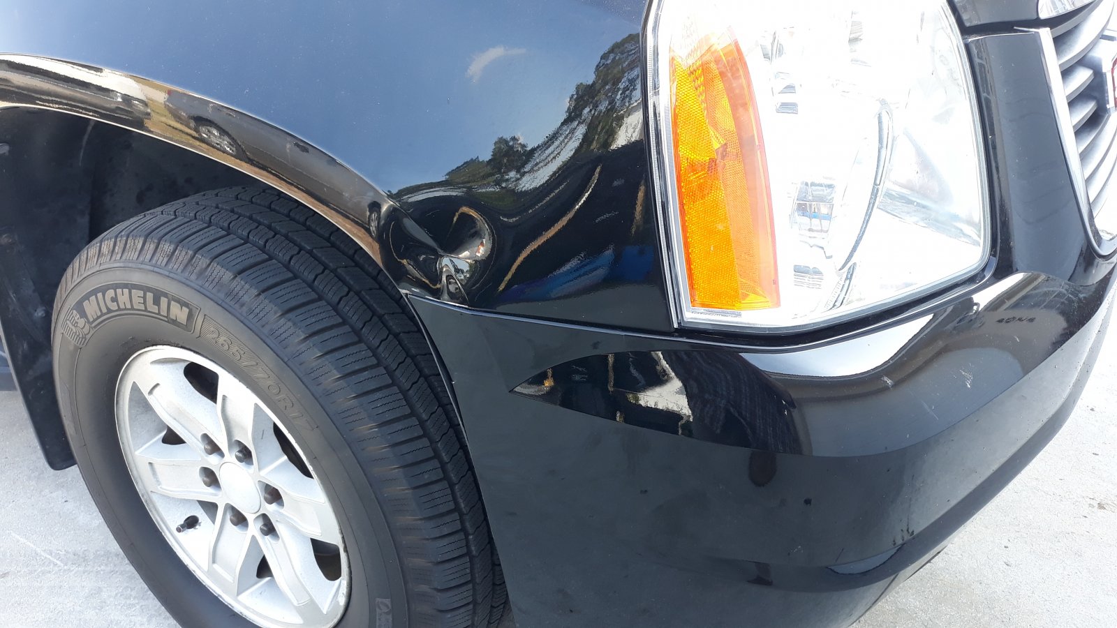

Oh, about a week ago, my other future son-in-law backed into my truck:
Grrrr!!!
Pretty sure a PDR guy can fix the fender and then the bumper will fit back into place. Unfortunately, the paint on the cover cracked and will have to be painted. Suggestions or comments appreciated!
View attachment 394869View attachment 394870
Grrrr!!!
Your former future son-in-law?
