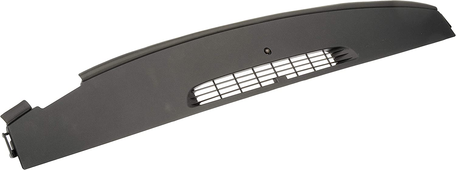

Is the dorman part just a dash cover??? Like lays over the original cover ??
Or is the actual top dash piece that you totally replace ????
It's a replacement piece that goes between the windshield and the main dash. It's the piece that has the defrost openings and also houses the ambiant light sensor (that little bubble that sticks up at the center)

If it wasn't so darn hot outside we would have put ours in today! By the time it cooled off we were too dog tired.
I used the seal that goes against the windshield off my factory one. It seemed to be better made.
got around to throwing this piece in this afternoon, color is a hair off but just chocking it up to main dash being in there (in the sun) for a couple years but looks 100x better. old one had more than half the tabs broke off. fit was great, texture finish is about perfect. the windshield seal you speak of, my stock one didnt even have a seal so dorman one went in, looked to be decent tho
