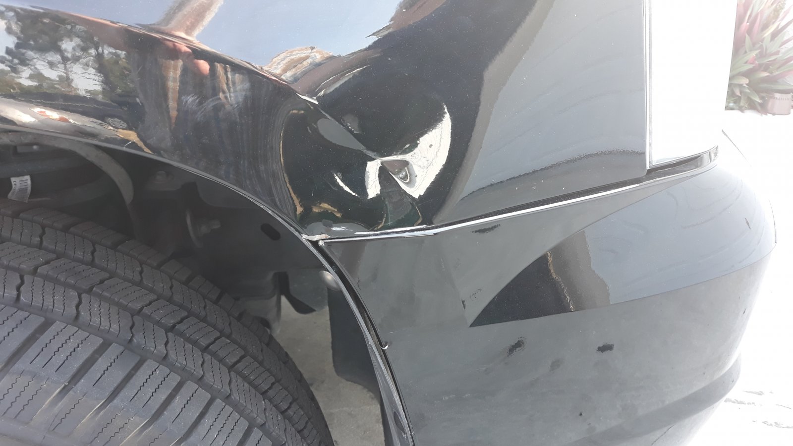

Yeah, right after we bought this one, I drove it through the yard and over the swale and promptly popped the front end and wheel well liners off! LOL Yes, the little RC shock spacers is what we bought. Alignment specs are critical. If I understand the art of an alignment right, in your case, since you like powering through those on ramps, you would want to put the caster at max settings.

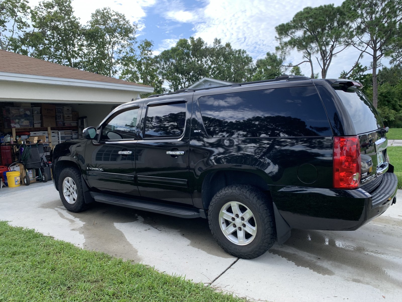

She's finally been claybarred and waxed and shampooed after a long spell. Changed the front differential fluid and transfer case and the rear and transmission are next. Then on to installing those drag reduction clips on the rear brakes some other things as opportunities arise with the coming cool weather, finally!
The painted buntings are back!

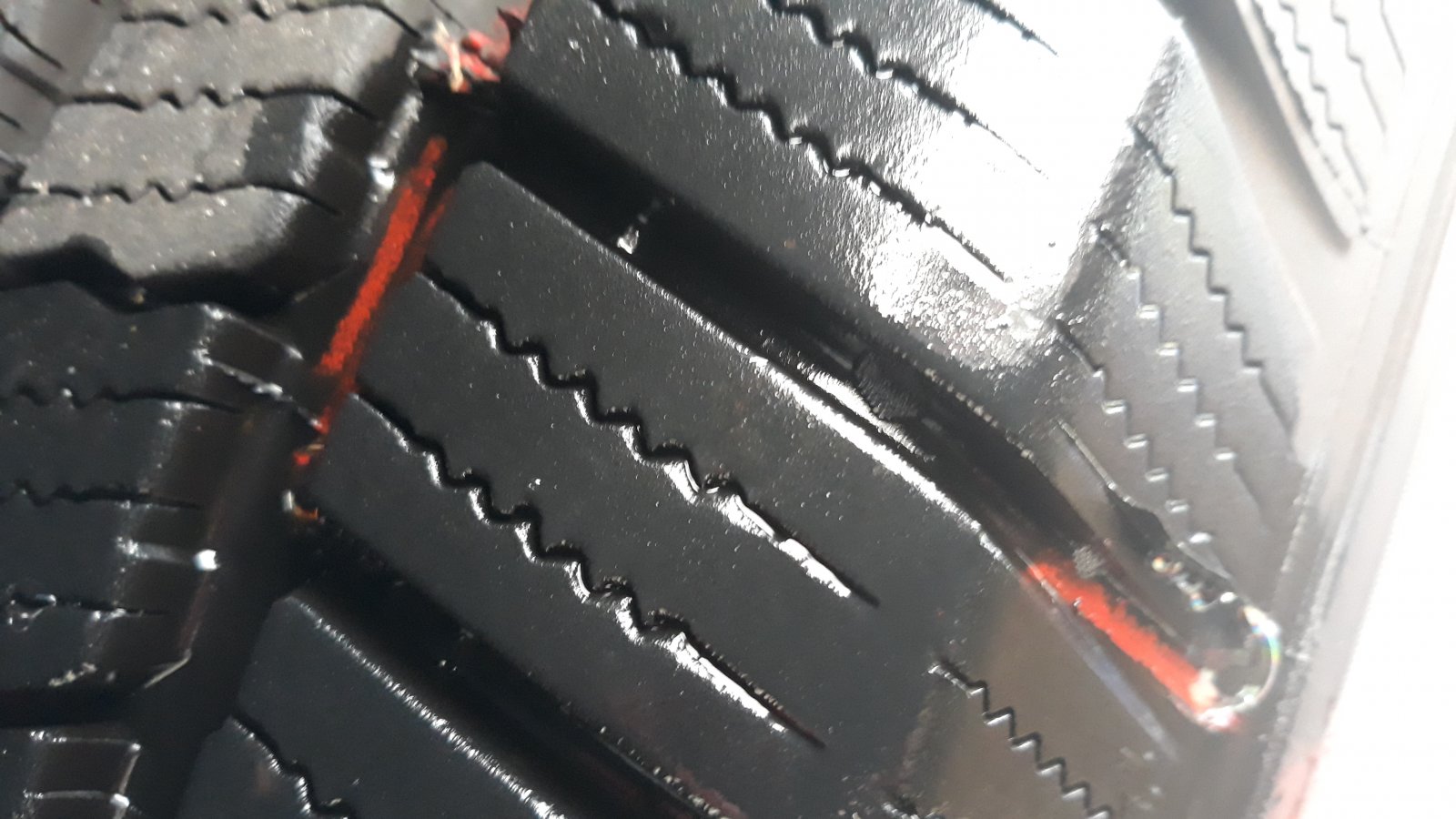

Really good! I’ve got the same toe on both sides, same camber at -0.2, and real close to the same caster. Drives great!
Thanks, how bad was it before they started turning wrenches?
I've got to get mine done, should have gotten 17+ on last trip out of town and it was in the 15s and now the wear on the inisde of the front matches the rear from when they were last up front.

It wanted to pull all over the road and I could feel it dragging the tires from the toe-in condition caused by the leveling spacers.
