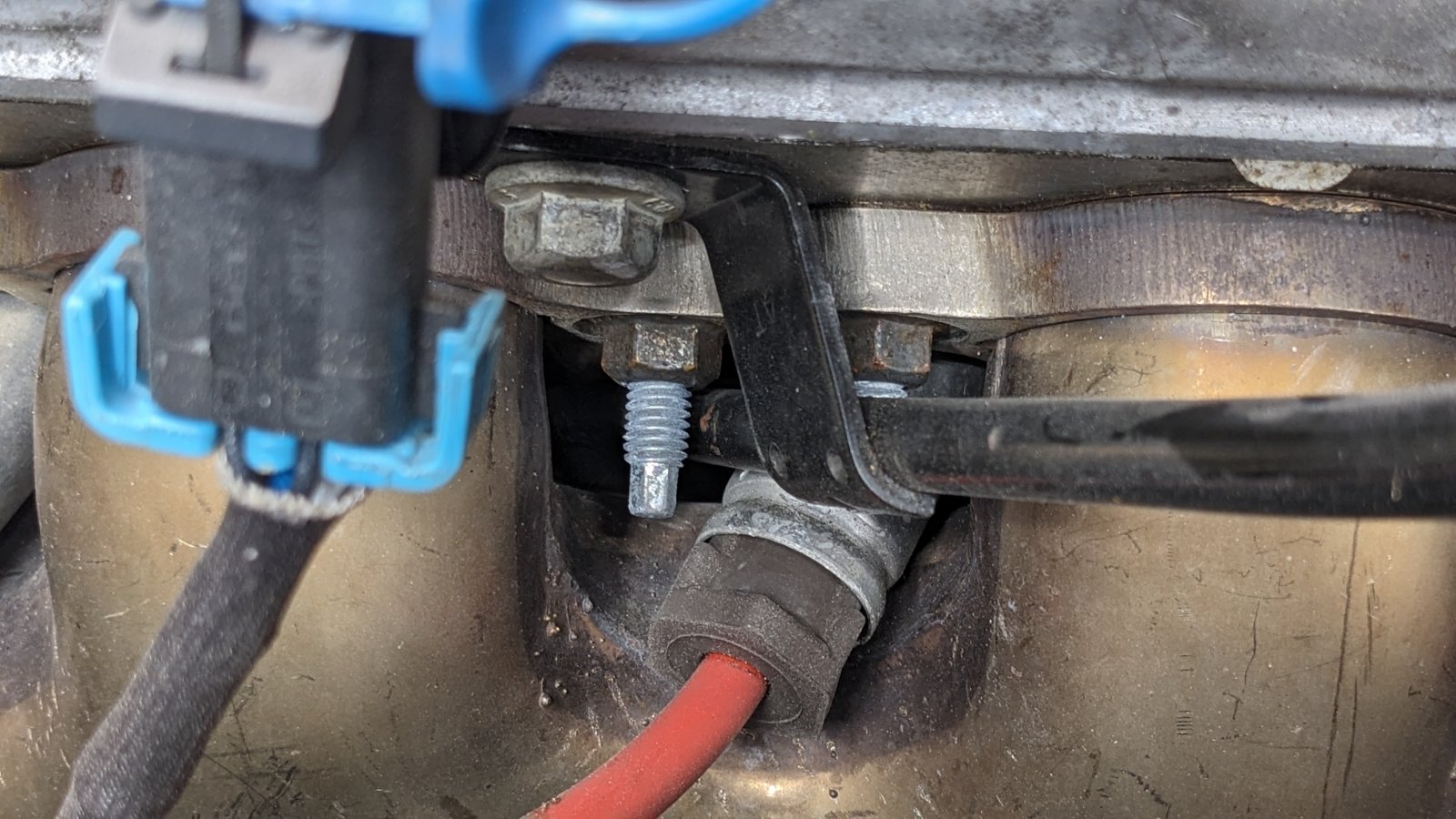

Do you have a part number for those studs?
I just stopped at AutoZone, and the only head studs they had in-stock were the wrong thread pitch.
Charlie207
Charlie207
Apr 13, 2021
1,900
3,791
LFOD, New Hampshire
I just checked with a tap, and confirmed by the assembly manual, and the exhaust manifold bolts are M8 x 1.25, which is different than the M10 x 1.50 that the Dorman parts list, even though they say it's a direct fit.
