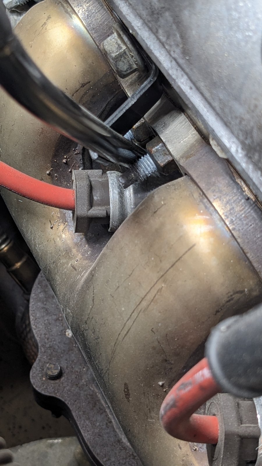

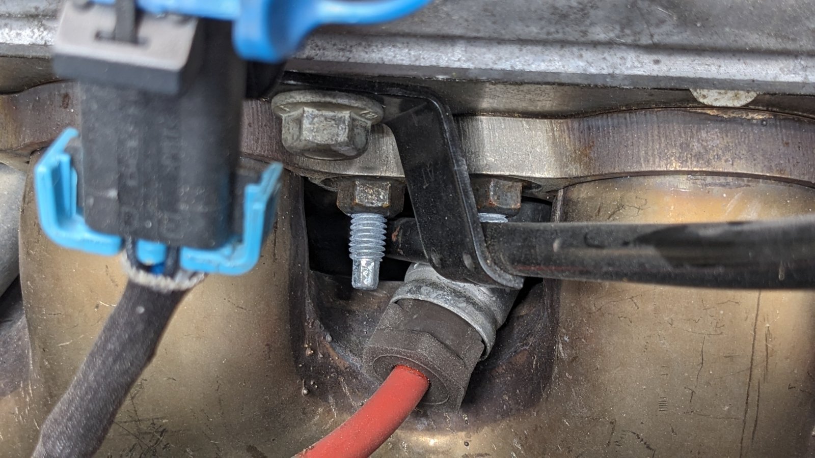

I honestly don't know what our truck dipstick looks like but here's the only tight part I had. I had the dipstick out when I put the headers(well manifolds but headers to me compared to stock) in. it was a bit of bend and or wiggle around to get in between. but no real issue
