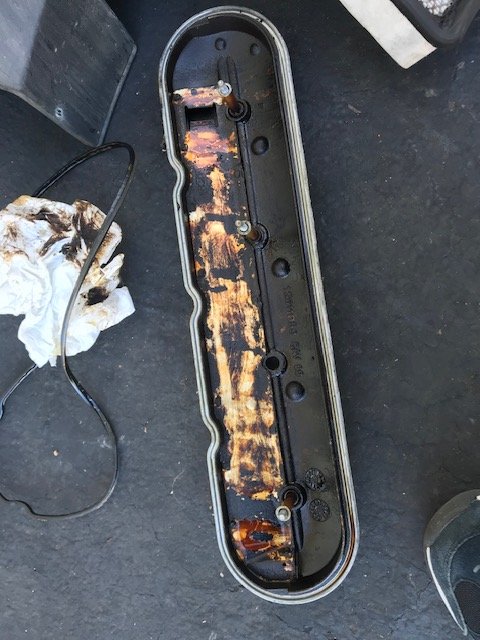

I'm a new guy here. While watching a utube video today about removing the oil pan, they talked about TSB 10-60-01-008M. WTF !
This TSB says to install valve cover # 12570427 on 07-08, and valve cover # 12642655 on 09 and later engines ONLY. There is a *NOTE* stating "These rocker covers are for specific years. The PCV orifice is different for each. The correct cover must be used or an SES light may set". There is a lot more scary info in it. I suggest you read it thoroughly.
I'll be installing the AFM pressure relief valve deflector,# 12639759, valve cover # 12570427, and doing the combustion chamber flush procedure while I have my oil pan off.

Just got my #12642655 valve cover delivered. I'll have to find a way to get a light inside the PCV port to see what the difference is between it and my stock cover. I think my borescope will fit. I tried to turn the nipple to see if I could break it free and pop it out, but it didn't budge. If I pinch it any harder for more grip, I'm likely to squash it. The casting number on the actual cover itself seems to be the same as any other cover, so I believe the actual cover is the same and the only change is to the PCV nipple/port and to the stainless baffle attached to the underside. So if the hole in the cover for the nipple/port is the same size between the two, I might can swap my original PCV port to this new cover. I'll handle it when I actually go to swap them. Worst case, I'll do as originally planned and modify my stock cover and pass this newer one on to someone with an '09+ motor.

Kinda... But this cover was $36 to my door. That makes it not worth my time to relocate the hole in my original cover, essentially making it the same as the #12570427. For less than $40, I have the relocated hole. I just need to address the difference in PCV valve or orifice or whatever it is, and I believe that'd be easier than cutting and welding the baffle. If I'm wrong, then someone with an '09+ will have a deal on an upgraded cover. On the other hand, I may discover a cheaper alternative to the #12570427 for the '07-'08 owners.
