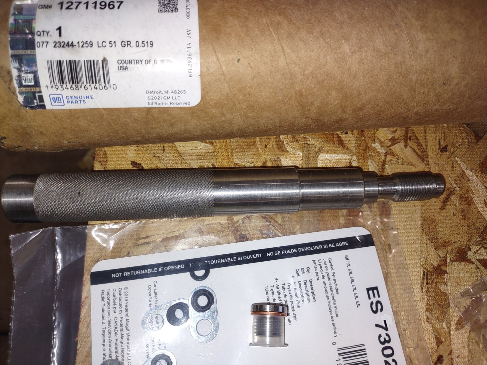

Well here's the results of two oil changes with the Valvoline restore and protect. 193,224 miles, diving in to my neighbors 2012 L94, deleting AFM. I'm satisfied the Valvoline did some good. I'm sold on it :) Note the plugs we tapped into the oil towers.

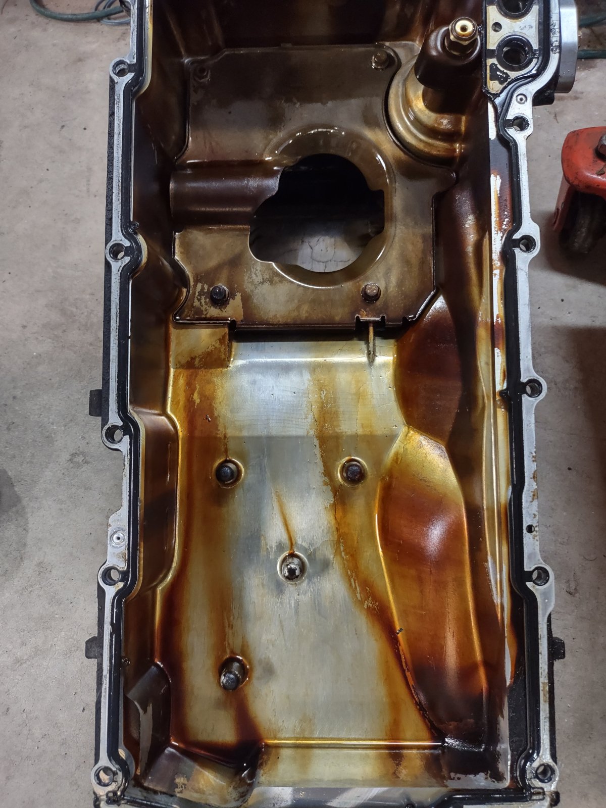

And here's what the oil pan looked like when we dropped it. Keep in mind this engine only had two oil changes with the Valvoline..... You can clearly see it was even working on cleaning the pan in the area where a lot of oil flowed down from the front. The very bottom of the sump was very clean aluminum, no sludge. Never seen that even on an LS with 90,000 miles.

Do you think the loosened sludge could gum up other internal areas? Like oil passages, push rods oil pump, oil pump pick up screen etc? Also what was the oil change intervals? I change mine every 2500-3000 miles. I do that on all of my vehicles.

Oil change interval was between 4 and 5000 miles for the life of the vehicle. The the pickup screen was clean, as was the screen under the oil pressure sending unit. Haven't pulled off the oil pump yet, but I want to look in the relief valve to see if there's anything there. But so far it seems to have pretty much dissolved any deposits, instead of just breaking them loose. Timing cover and oil pump, etc coming off tomorrow with pictures.

while I've seen that nice orangeish red in just about everything engine I've ever seen inside of with any good amount of miles/hours on it. I used to consider that a happy well maintained engine and was happy to see it vs any build up or black gunk. I considered them totally different things.
but I can't argue that it's nice to see it clean that up even if I don't really see it as something leading to an issue. not seeing much down side to running this oil over anything else right now.

Am I missing something here? Where's your 'before' picture?
