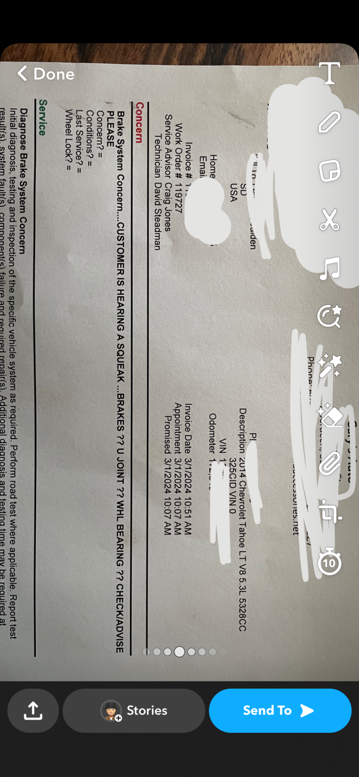

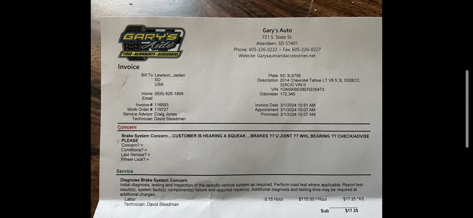

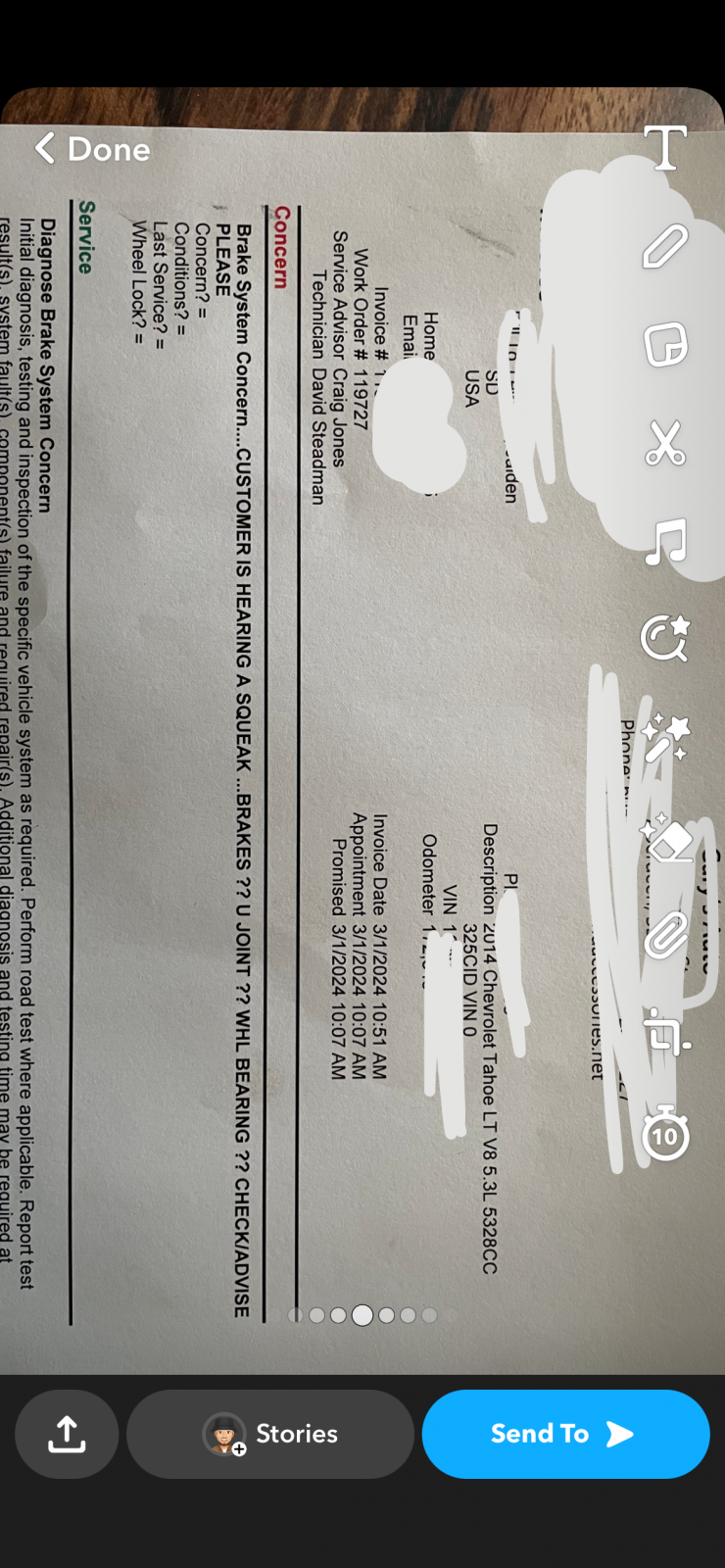

Want to add that my 2014 Tahoe has 172300 miles.
I also recently took it in one morning for an inspection bc I’m going on a trip soon. (Took it on a 500 mile round trip to Minnesota 2 weeks prior and it drove fine, it still does)
any ways, Said they didn’t hear anything and had the vehicle back to me that afternoon. Wonder if they even looked or did an inspection. Went back to pick it up and the same three Yukons were on the lifts. They don’t charge me anything and i specifically asked for an inspection. Guess im confused bc it’s a reputable shop based off the reviews.
If they couldn’t hear anything while driving it, they probably didn’t bother putting it up on a lift.
As @Dustin Jackson suggested, you might have a brake hose at one or more of the wheels that’s starting to break down in the inside restricting the brake fluid from letting the caliper fully retract.
