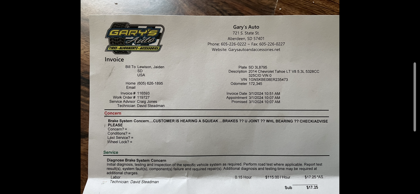

Don’t have the stuff to do that. I did take it to a reputable local shop and they said it’s most likely debris, salt or a rock stuck somewhere. I’m not sure exactly what the mechanic all did I’ll call back and ask. I know he said he cleaned the brakes and rotors. It was less than an hour so not sure what he all did in that time. Imagine he checked the wheel hub for play and stuff?

They said pad thickness is good.
My trips is tomorrow morning and I’m not really confident doing that all myself to be honest. Two shops said it’s fine so I guess I’m just gonna ride it. If it it gets worse or something tragic happens I’ll limp it or tow it to where I’m traveling and get it dealt with. Not gonna lie I’m still anxious bc the noise is still there.

Says wheel hub was checked
