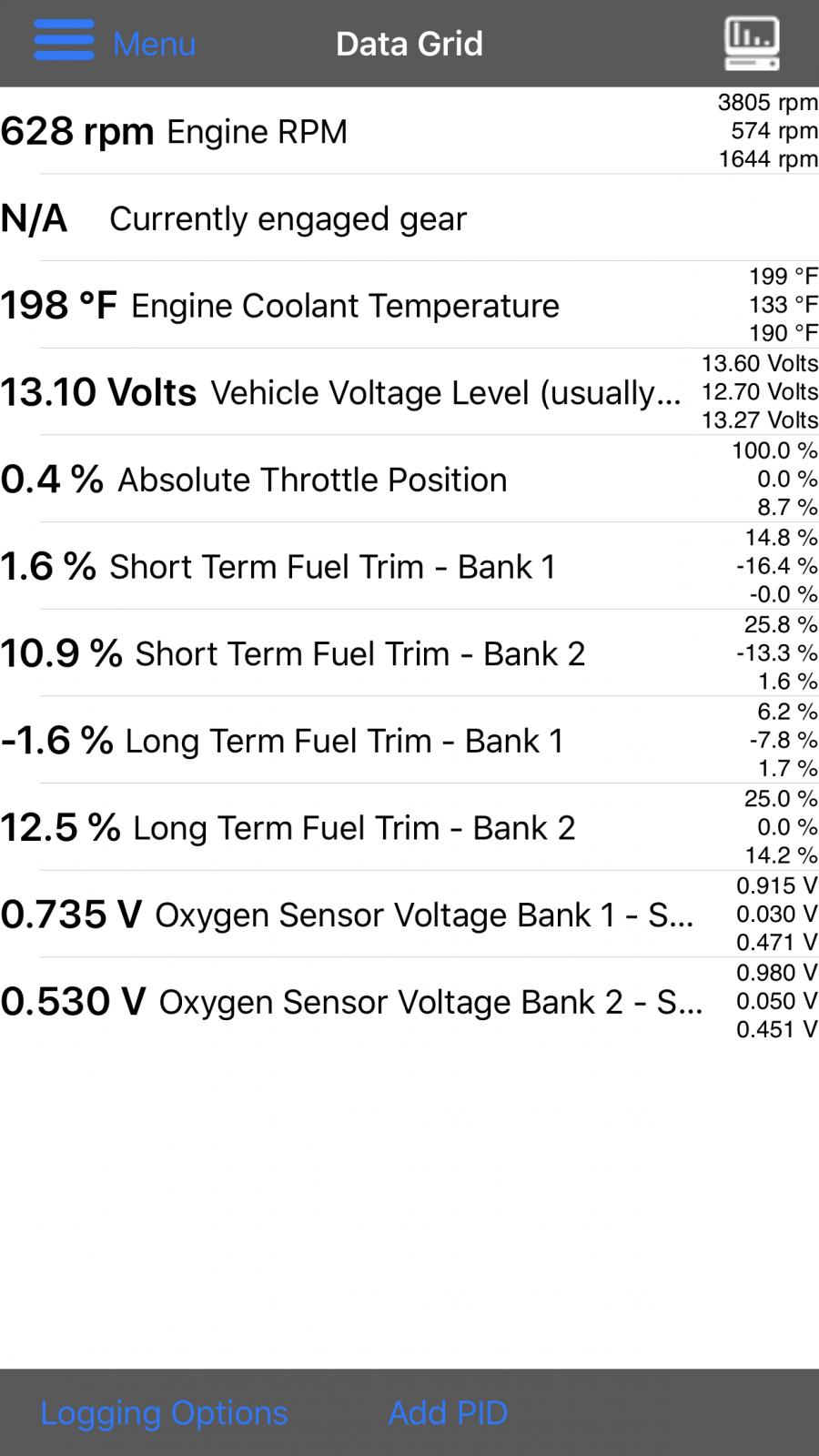

Here are two screenshots of PID data from a 25 minute drive. Numbers to right go Max/Min/Avg. A couple things to note: LTFT on Bank 2 Max and Average, and the Absolute Throttle Positions. At idle, the throttle would bounce between 0.4% and 0%

Here’s another from this morning. I drove around in 3rd to keep OD from kicking me back into third, and to keep it from hard shifting.
I noticed a few things... as RPMs went up to around 2500, the LTFT on Bank 2 would come down to around 9-10%, indicating a vacuum leak. If I put more load on the engine by accelerating, it would start to rise, which would indicate a fuel issue, as well. If I let my foot off, it would immediately dip back down to about 8-10%, then start rising back up. As you can see, at one point in time I did get the LTFT on Bank 2 down to 0%, but that was probably under one of my harder accelerations to see what it would do. STFT on Bank 2 is still a bit of an issue, but I think it’s related to everything else.
Thoughts?
