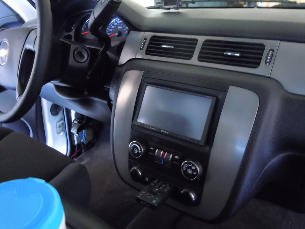

I added a Kenwood DNX-7120. By no means a brand new unit. It has Garmin, updated to most recent maps. The ability of Ipod control through face of the radio and several other features. Got it on ebay with Sirius SCC1 turner for 325.00.
then I added this little gem to it....

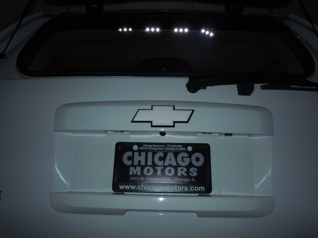

Paid $30.00 some bucks for it.

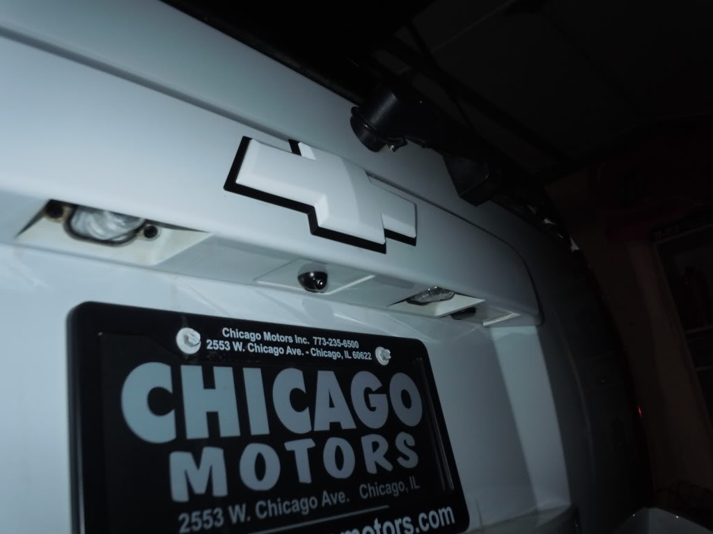

Here is a shot from a little distance. It is almost unnoticable...
If you search for the back up camera now you can find it as low at $25. I have it run on a contiuous power since I pull our jet boat here and there. Its a nice little feature being able to see the boat, and having the camera assit with launching it.
