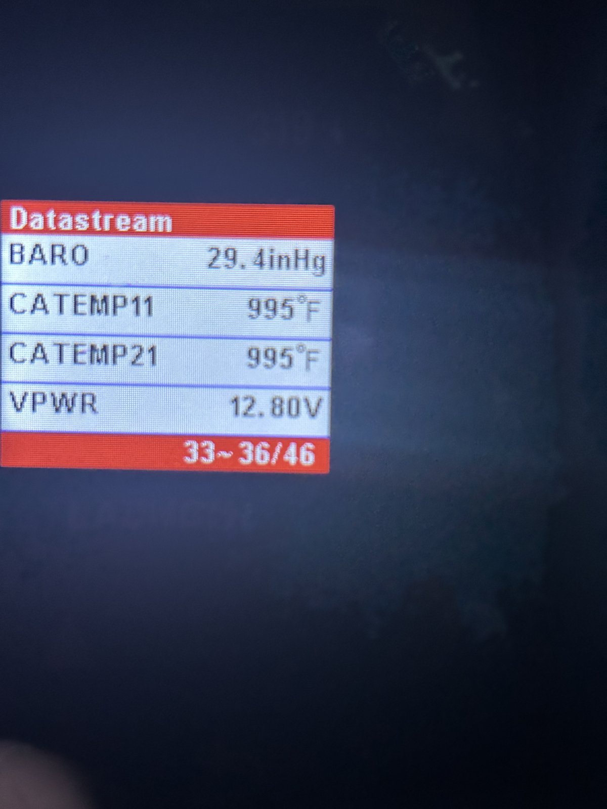

I'm not one to throw darts, but with your symptoms and a 4+ year-old battery, that'd be my first reaction. Not saying it is 100% your problem, but the battery is aged and you finding it having 12.18V at rest is at least identifying a future problem.

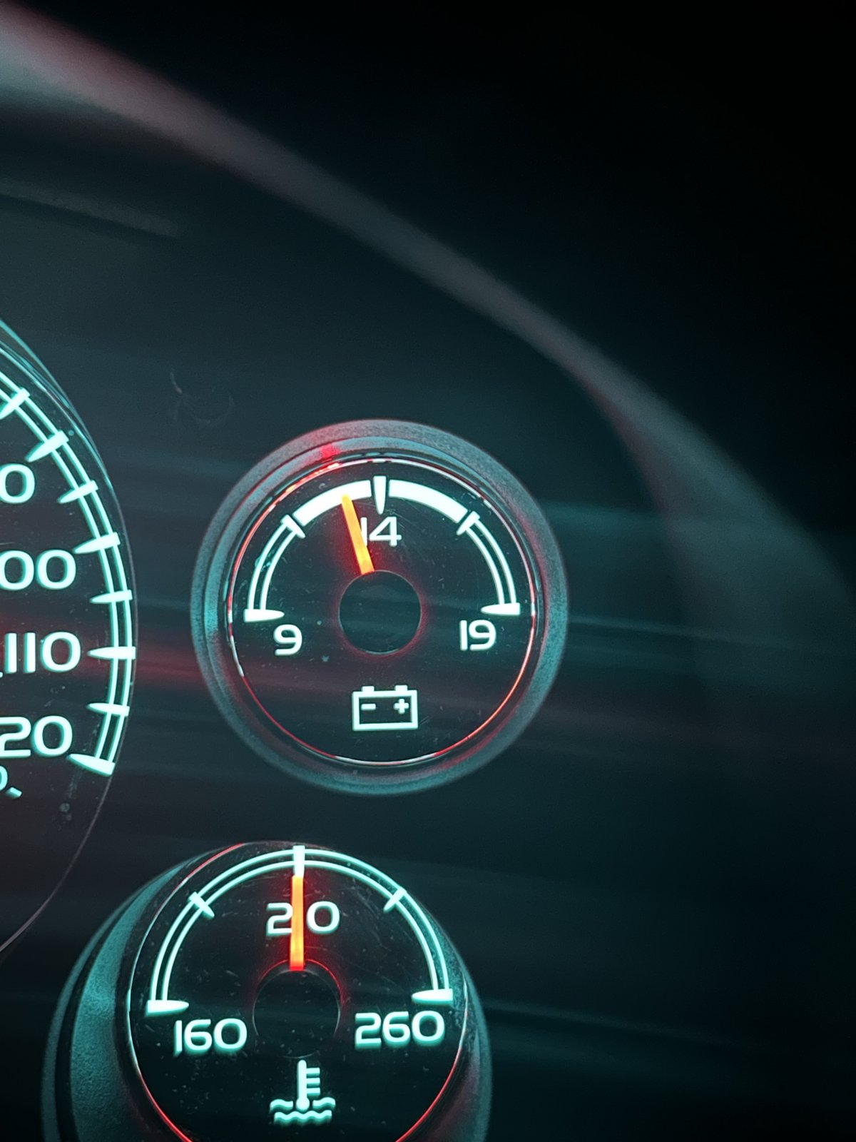

I 100% agree with you no doubt, so far everything seems good. But I’m still keeping an eye on it for a few weeks to see if it will do it again. There was no pattern to the dimming and it only happened once on 2 separate occasions, 2weeks from each other( must be a Monday thing ). I only can notice it at night for the first 5-10 minutes when my headlights are on.
I am firmly leaning towards that battery. Since it only does it for a short period of time and then disappears. Usually with an alternator there’s more pronounced symptoms that are consistent and those aren’t strongly present enough to lead me believing that it is the alternator. But with 132k miles now it wouldn’t hurt changing out the alternator as a precaution and stuff the old one in the back for a rainy day
