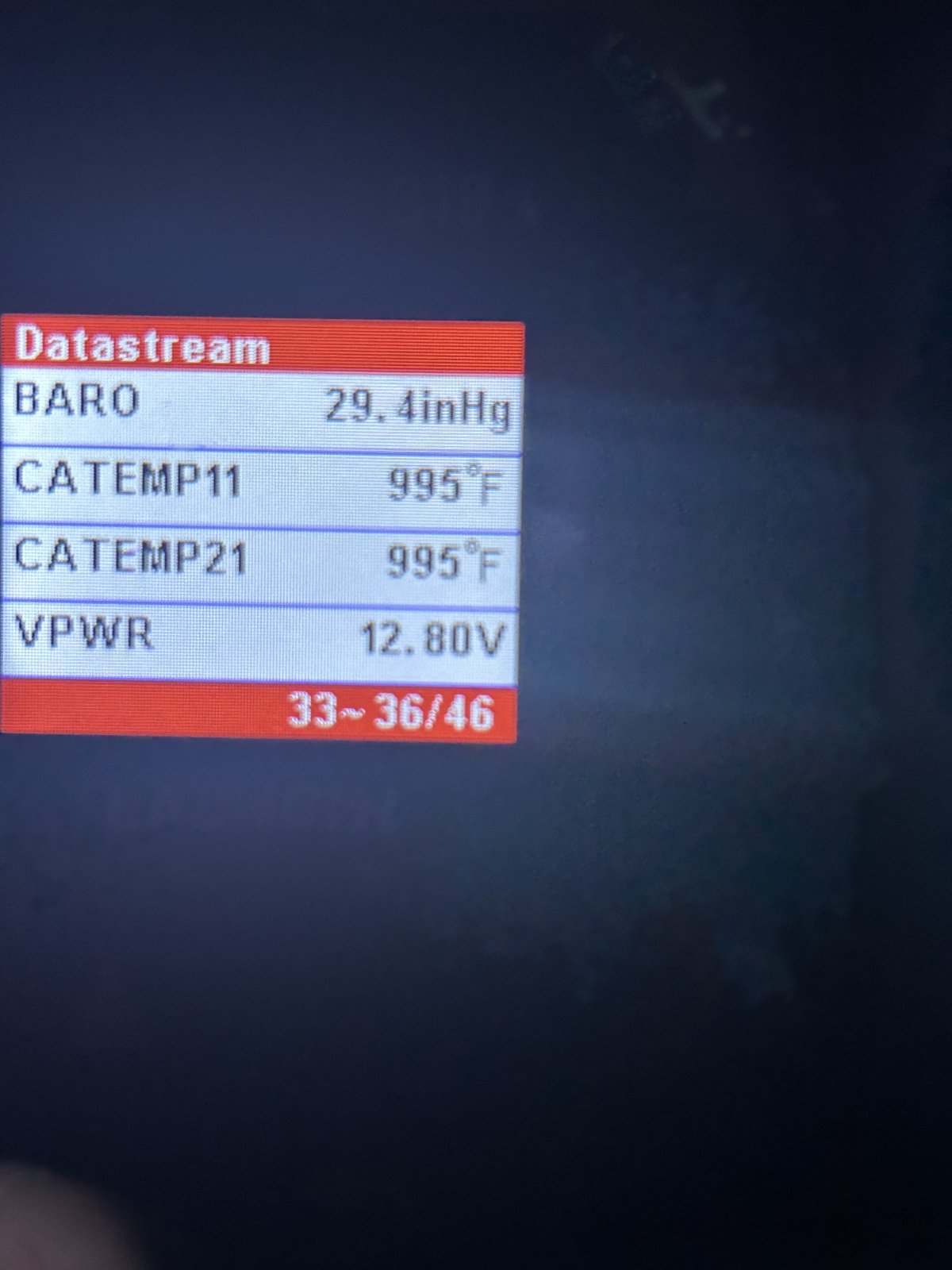

Update… my voltmeter on the instrument cluster is slowly moving from 12.80 to 13.50 volts. Am I going to be going alternator shopping? When I start my vehicle it’ll go above 14 and after driving around it’ll slowly go back and fourth

I replaced the alternator this morning , and in the midst of putting my engine cover back on I broke the white hvac heater hose t valve. So while I was at it I went ahead and replaced the black one also since they’re known for going bad and topped off coolant. However I started her up and the voltage immediately when back up to 14.75v and is holding steady not moving around. So I think that was the issue.
