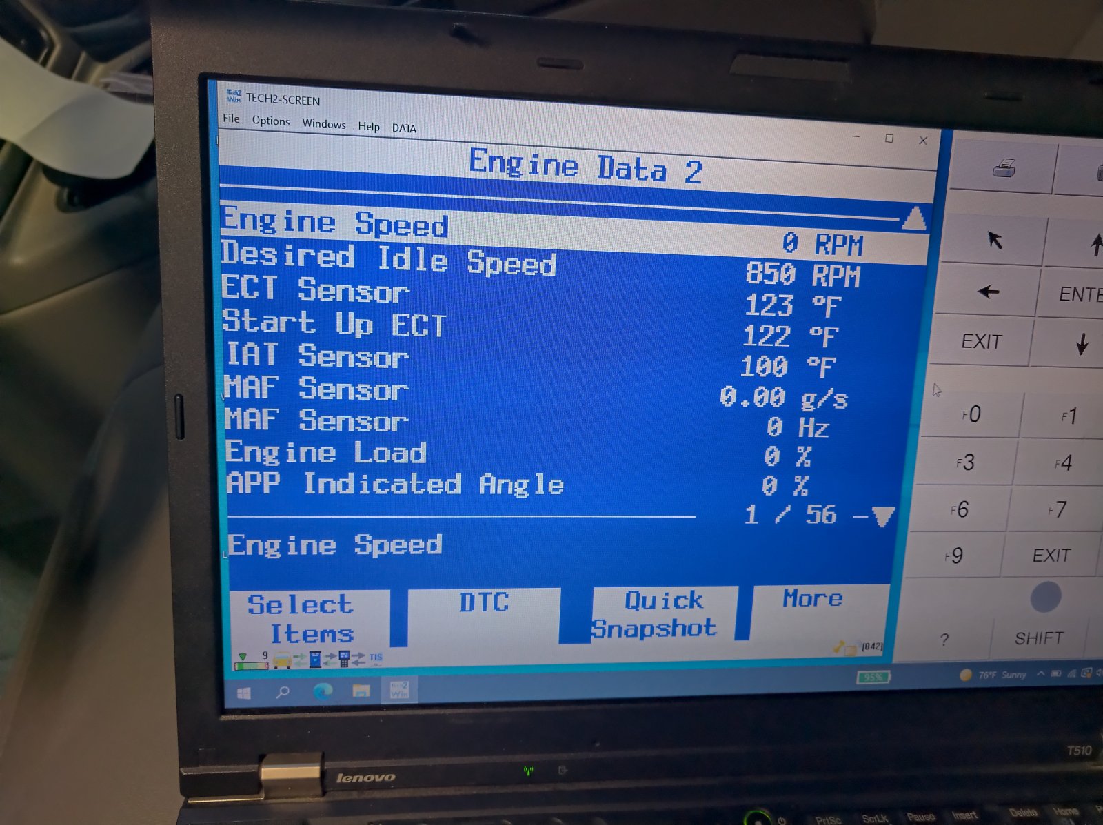

Alright so here's the readings-
Cold readings Not Running:
MAP-29(inHg)
ECT-32 degrees
IAT-32 degrees
With Truck Running:
MAP-10(inHg)
ECT-60 degrees
IAT-32 degrees
MAF-1.37(lb/min)

The ait is supposed to be what the temp is outside, so everything makes proper sense in your data provided for both key on and running. (Assuming it's 32 degrees out)
