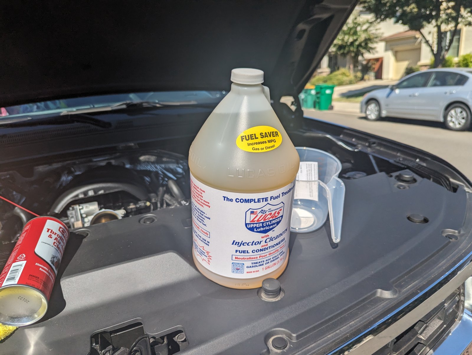

Cleaned the throttle body and maf and new air filter, doesn't look like it was ever done, cheaper to buy the injector cleaner by the gallon anymore since I use it on all the vehicles 12oz per tank full once in a while, this thing runs pretty good but I do notice a very slight hesitation usually cleaning the intake and some injector treatment for a few tanks smooths it out

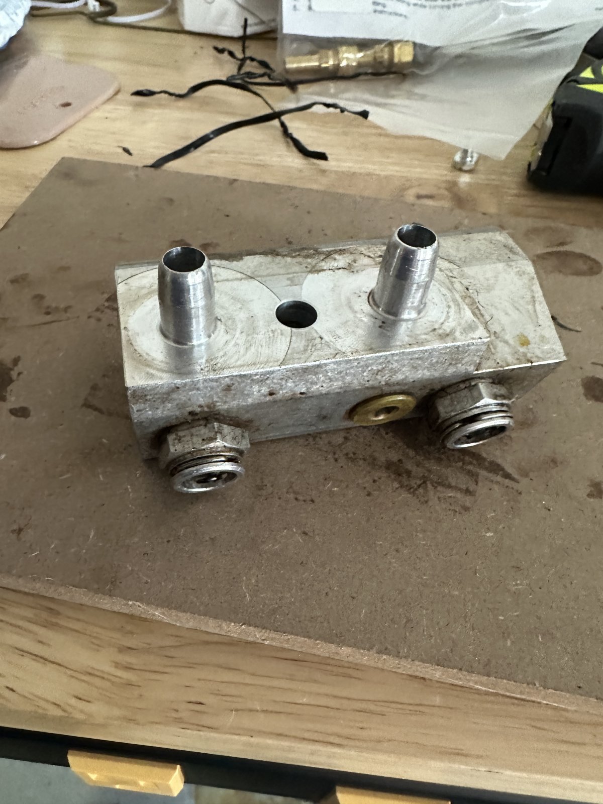

Installed the thermostat bypass for the transmission View attachment 407102
Did mine this morning. I hate these quick connections. I thought everything was peachy. Idled until it started warming. Went for a test drive, and the one toward the top popped loose. F#$&&king mess. Deputy pulled up thinking it was on fire.
Got under and the line snapped in. Audibly and by touch. Had some fluid with me so added it. Started limping home. Almost there and that connector popped again.
In case anyone needs the quick connectors, they are:
GM 19210848
NAPA 730-5088
Dorman 800-727
Any parts searches will probably need to be for a 2014 Tahoe.
