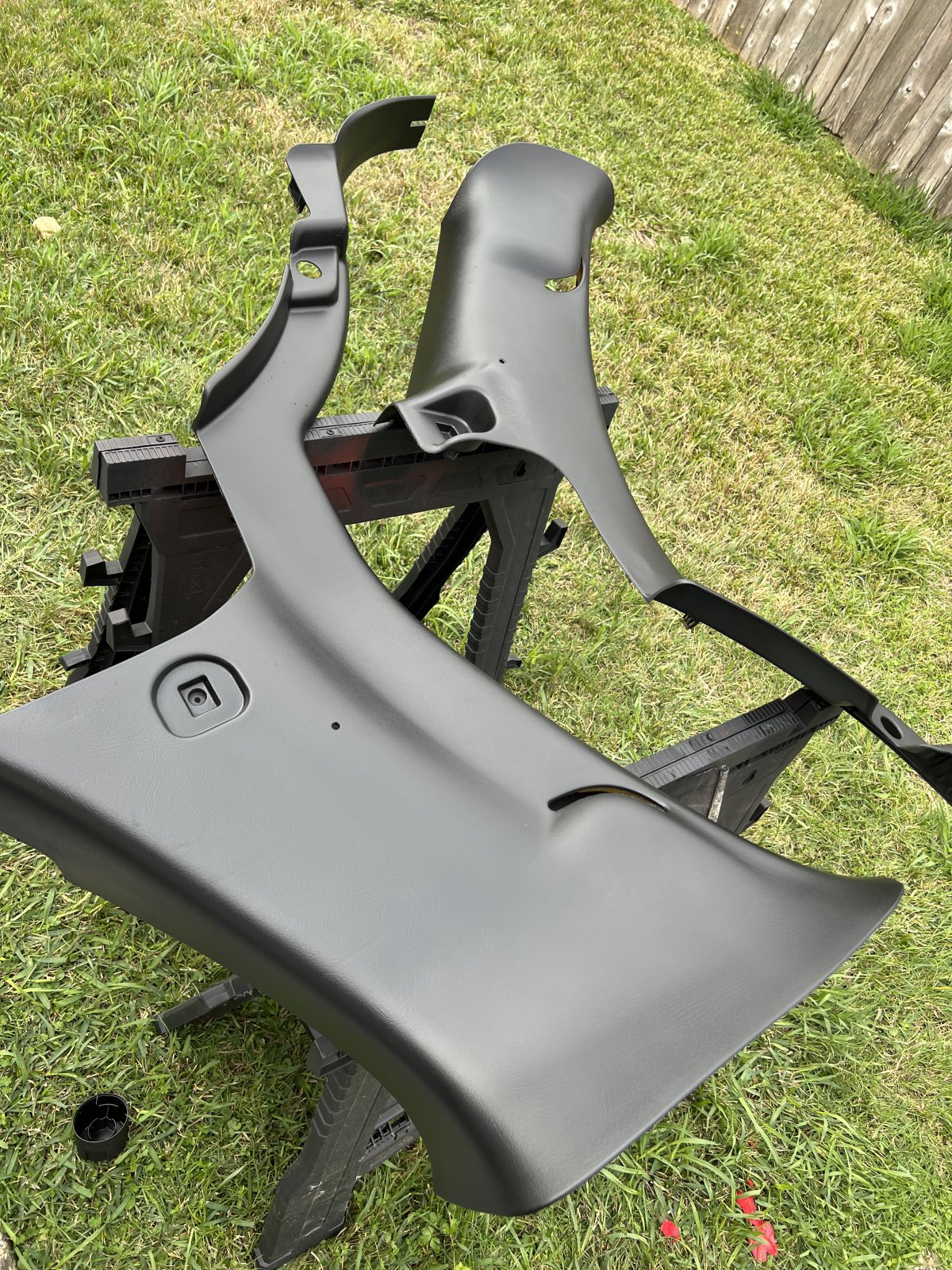

not today but 2 days ago on Saturday. I replaced the Auxillary rear air resistor for the fan speed control. The 1 & 2 speeds were not working leaving only the 3 setting to work. Alternate/OEM Part Number(s): 12477721, 88986482 for $61 from RockAuto.. the process is very simple. remove the rear cargo net screw out nub, pop out the lower panel tree plug, remove the lower and upper door trim, remove the rear pillar trim, remove the 5.5mm bolt on the passenger door seat belt trim by the cup holder. now you can pop the rear corner of the lower cargo side panel out and access the regulator at the rear of the fan. You have 2 nut bolts and 3 wires to disconnect. MAKE SURE THE VEHICLE IS OFF!. reverse process and let that cold AC blast.
