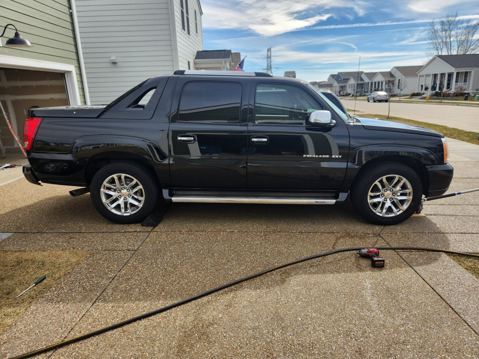

finally got a warm ish day and the ambition to break out the buffer and go to town on the hoe.
crap pics, the sun was setting and was very strong. good old parking lot life.
i even did the roof, unlike most im sure.
while waxing, i notice the pass side floor was wet so i pulled off the sill and the carpet and padding was soaked, so i put a towel between em and stood on it a few times to help dry it up, then stuffed some crap under the rug to lift it up so it can dry , is there a common thing that leaks down there? i pulled the a pillar trim, theres no water trail, and the head liner is dry. thinking it might be the xm antenna i suppose, if thats the pass side box on the roof.
and its not coolant, it just water, sill to about 1/2 way to the console was wet.
What’s the door weatherstripping like? My driver door one was shot and leaked like you described

ill have to take a closer look at that at that. thanks for a place to look.
trucks still new to me and have not looked at every little last thing yet.

No problem, let it dry out and if the weatherstripping looks ok to a garden hose on a warm day and spray the door and see if that causes anything if that doesn’t cause it make sure the cowl drain on that side is clear

water test was the next thing after i checked for anything thats super common from you all knowing forum people. helps when you been around a platform, you pick up on the common stuff even if its not happened to you yet lol

You gots a suns roofs?
Something about drains going down the a pillars and being clogged....supposed to drain behind the front wheel well liner....i think
i blew them out last month when a new stain showed up on the moon roof slider. then dumped a glass of water in the drain pan and i got water from both front fenders @ the door and behind the front doors. so pretty sure those are ok.
