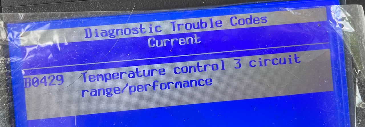

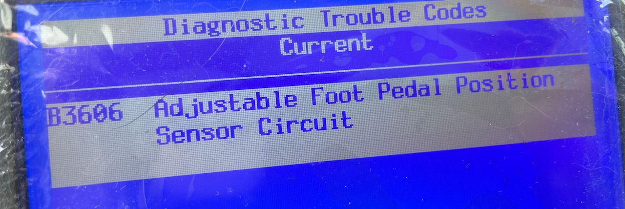

Got it fixed,... think it was secondary positive cable on battery,...odd though because truck would start fine! ..which is usually the largest draw,.. go figure.?

Thats good. Often weird problems with multiple issues are related to something like that grounds/battery/battery cables. I still end up chasing my tail most of the time before I check those though hah
