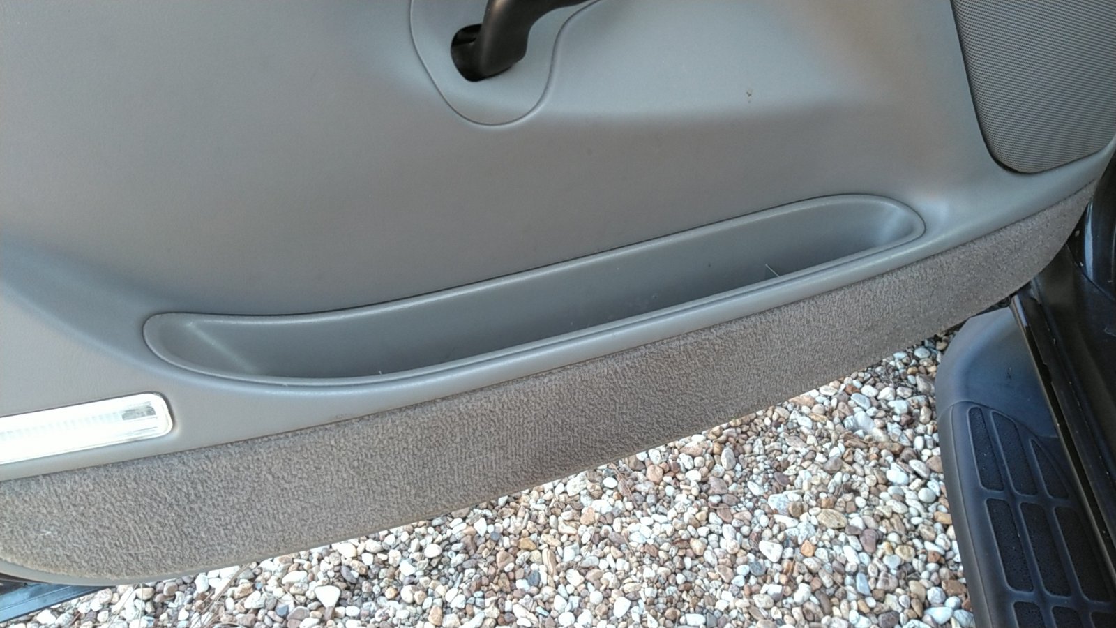

Tony (etal).... Thinking about mounting my 6' LED strip under my front door panels......
Instead of having to remove the door panel, I notice the panel 'map pocket'.....
Anyone just remove the pocket, while the panel is on the door?
'cause, maybe I can access the powered panel light & even gain access to the bottom panel when the pocket is removed. ( I avoid at all costs, un-doing the panel)
....... I could 'test' removing that pocket, but I don't want to risk breaking something.
( I added PICTURES of my panel due to different year/ models)

That pocket is attached to the door panel with screws from the bottom of the panel which can only be accessed by removing the door panel. It’s easy to pull the panel off.

Iirc, you can get to the screws from underneath(outside)the door panel and the picket will slide out. You can squeeze your hand in that hole and try to grab that wire, but it really isn't too bad to remove the door panel.

Ahhh yes you are right, I just looked. You can pull those screws with the panel on the door.

Thanks all...... I will also need to mount the LED strip.... ( not sure best way, yet ).....
But your suggestion, ..Better to just remove the panel for ease of access. ( So much for a short cut)
I used LED strips with 3M high bond adhesive tape on them, cleaned the area with alcohol and dry wiped it, and stuck them in place across the bottom of the door. They’re still on 2 years later.
