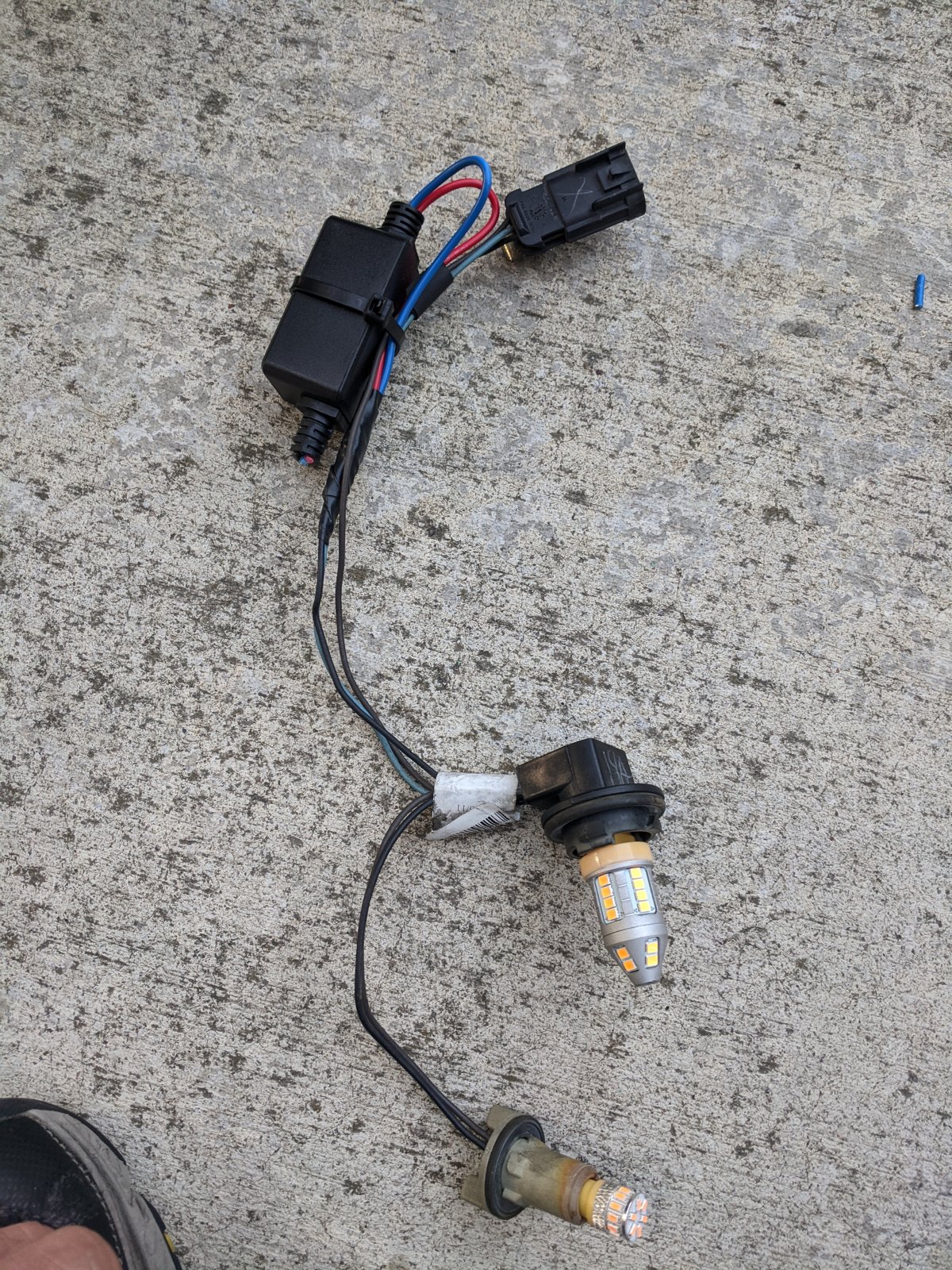

Well I was back to working on the truck some more today.
Well I actually started yesterday, so in total about 6 hrs into this little project
Replaced the rear view cam, removed the amp that never got used, and cleaned up a lot of my wiring to a simpler set up.
This is what all was removed
Now after getting everything back together; put in reverse and no cam. Oh well try again tomorrow. And I tested it every step of the way.
