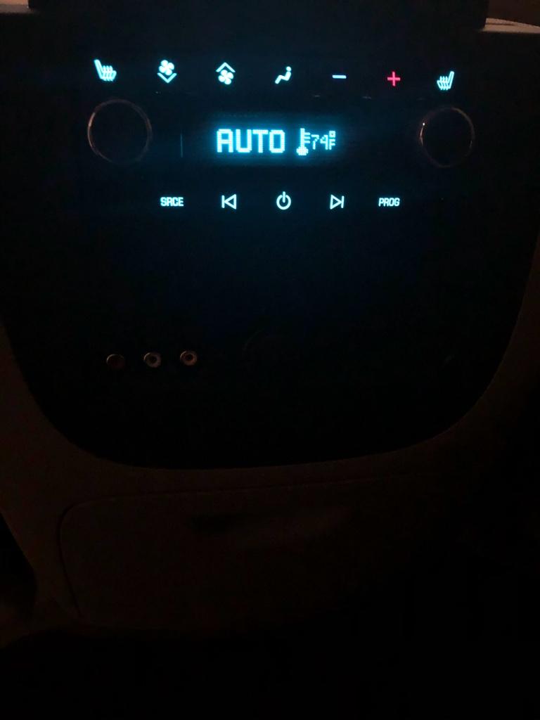

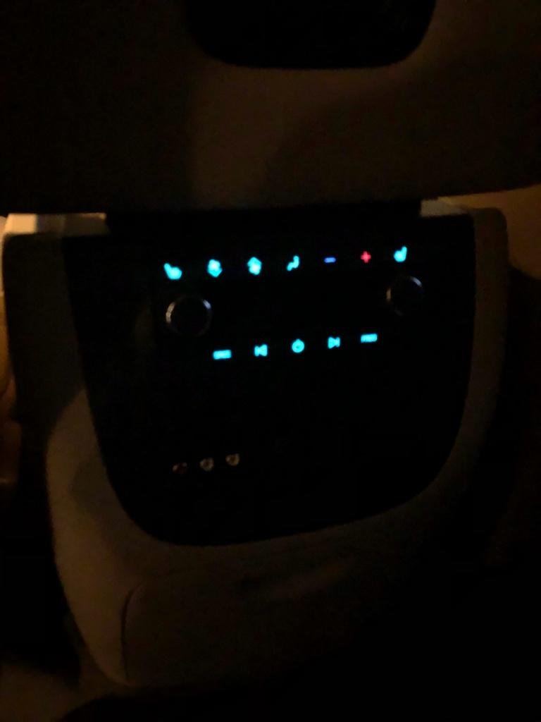

been trying to troubleshoot a hvac problem I'm getting a code b0168 and b0433 which is a open circuit/short to battery on the passenger rear temp sensor and a rear actuator, well apparently nobody knows what or where this "temp sensor" is, finally after going to the dealer parts department and scouring diagrams there is at least 2 sensors inside the rear hvac ductwork, I read there is actually up to 11 sensors that control the heat/cold, what a freaking headache, at least the (hopefully) two possible sensors are only $4.50 each and have to be ordered. so i'm going to order those and then deal with whichever actuator when I have the rear hvac cover off.
also found out that the bose premium system has 3 inside microphones I thought there was only 2 and that the rear little rooftop speaker grill is just another mic and not a rear temp sensor (after I tore my arm up trying to pull it out from inside the headliner) fun fun
