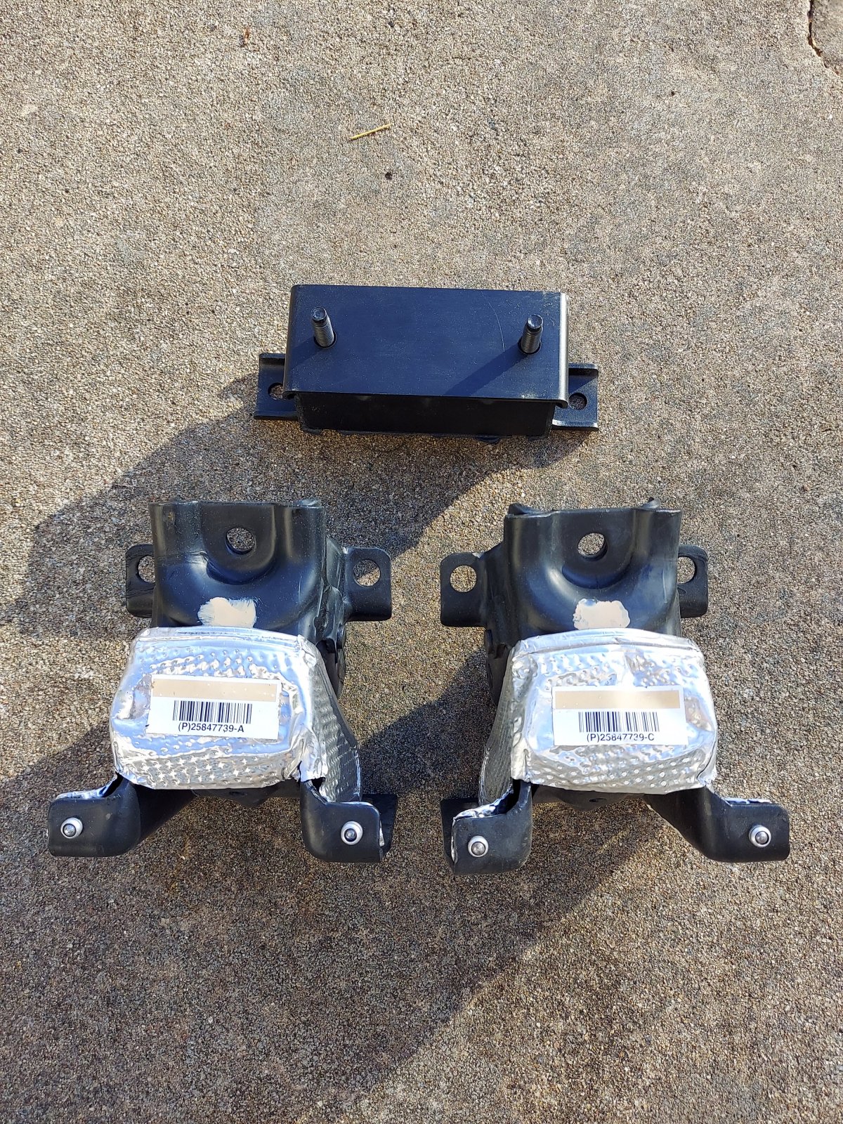

I've been chasing a "clunk" since picking up my Denali about this time last year. Within the last year, both motor mounts and the transmission mount have been replaced. It's still there on aggressive downshifts, so I'm thinking front differential mounts since it's an AWD.
There isn't a ton of information out there about replacing them. Apparently the two approaches are to get the bushings, press the old out of the brackets/arms, press the new ones in. Or just replace the entire arm/bracket which is a little more expensive, but less hassle.
I'm struggling to find the correct part numbers. I'm coming up with two sets...
15201932 (right)
15201933 (left)
23104735 (right)
23104736 (left)
Anyone done this job? Any tips? Insight on the correct part numbers?
