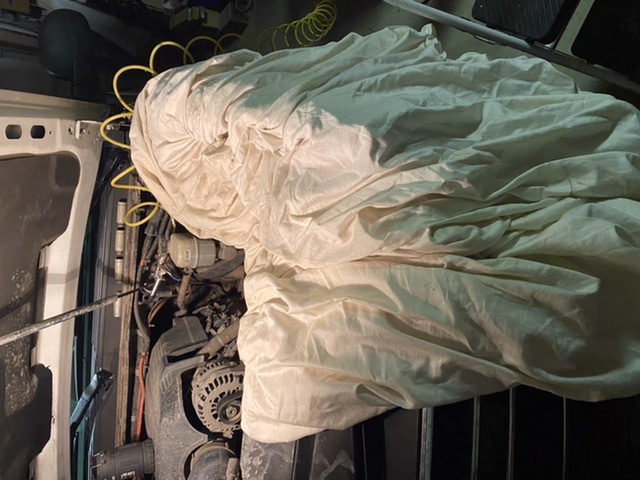

Moved my Tahoe to the driveway to park my brother's '05 Sierra CC in the shop to diagnose slow coolant loss and, more recently, no/low oil pressure and severe lifter noise. So far I've confirmed a Castech head failure. This poor thing is so sludged-up inside that I don't know if I'll really be able to see if the low oil pressure is from wiped cam bearings or a clogged oiling system. Oil filter had rather solid chunks coming out of it. It's really looking like I'll be swapping in a new long block. Gonna pull the cracked LH head and see what the lifters and cam lobes look like. Poor baby only had 181K on her.
