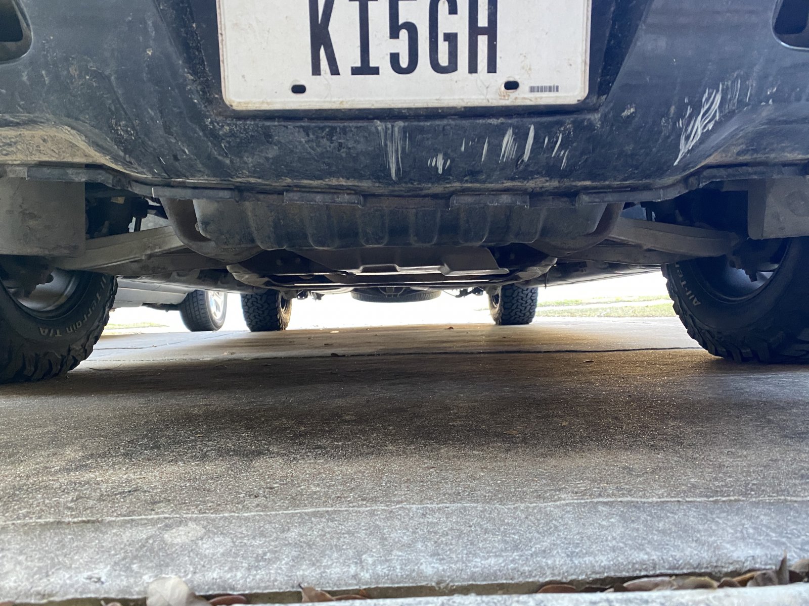

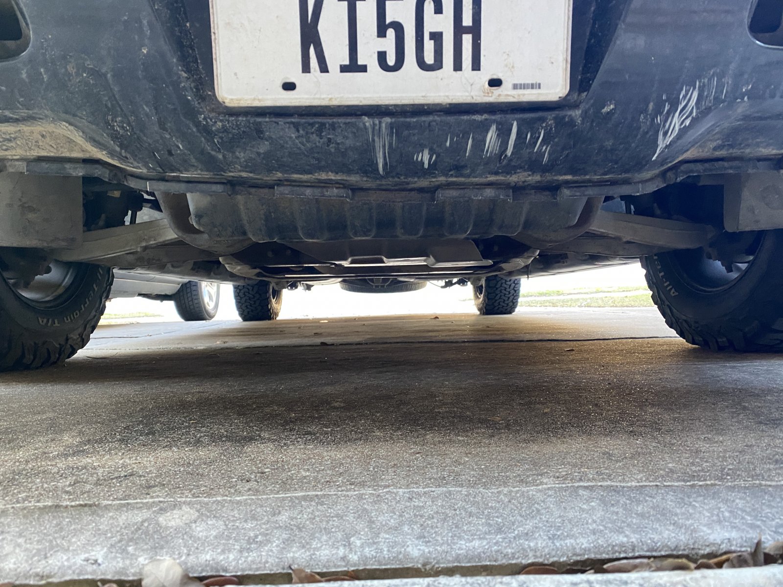

I did the rear end finally. I had to use a 12mm socket on the rusted 13mm bolts tapped on with a hammer to get them off. I also used a propane torch to help loosen them up. The new Amsoil containers are awesome! Installed new stainless bolts.
And a new cover!
