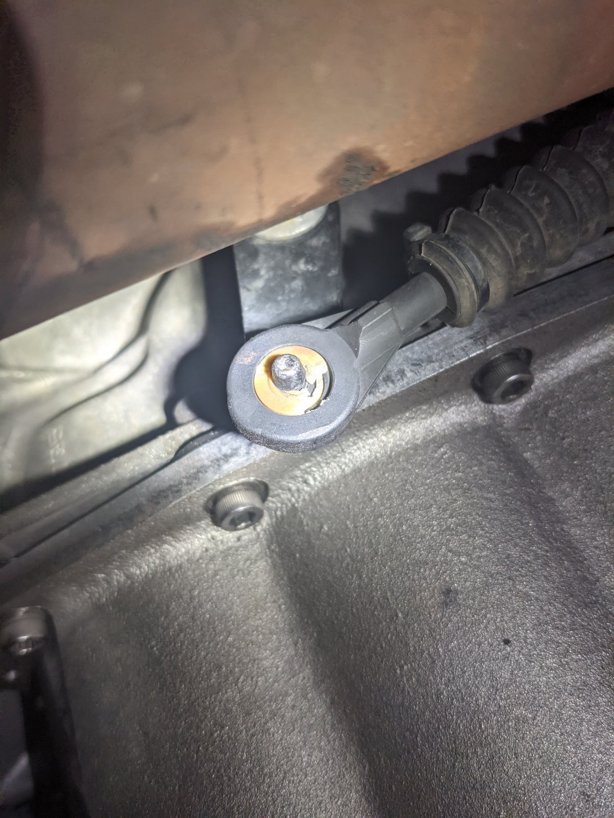

Decided to replace the front sway bar links and bar bushings. Both links were broken! This was a surprise and explained the heavy roll I was experiencing.
Broke a motherf*****g bolt. Wow did that eat up a good three hours of my day off. Busted three drill bits and one M10x1.5 tap. Thankfully I have more taps. I ended up blowing the broken tap out of the hole using my Victor Oxy-Acetylene Porta Torch. Tomorrow I’ll install a new M10 bolt (that I still need to buy at the store) and do the rear sway bar links and bushings.
**EDIT** Added photo of the new stabilizer bar bushing bolt. M10x1.5 thread and it is a grade 12.9 M8 socket bolt that is 45mm long ($1.23 at my Auto Value):
