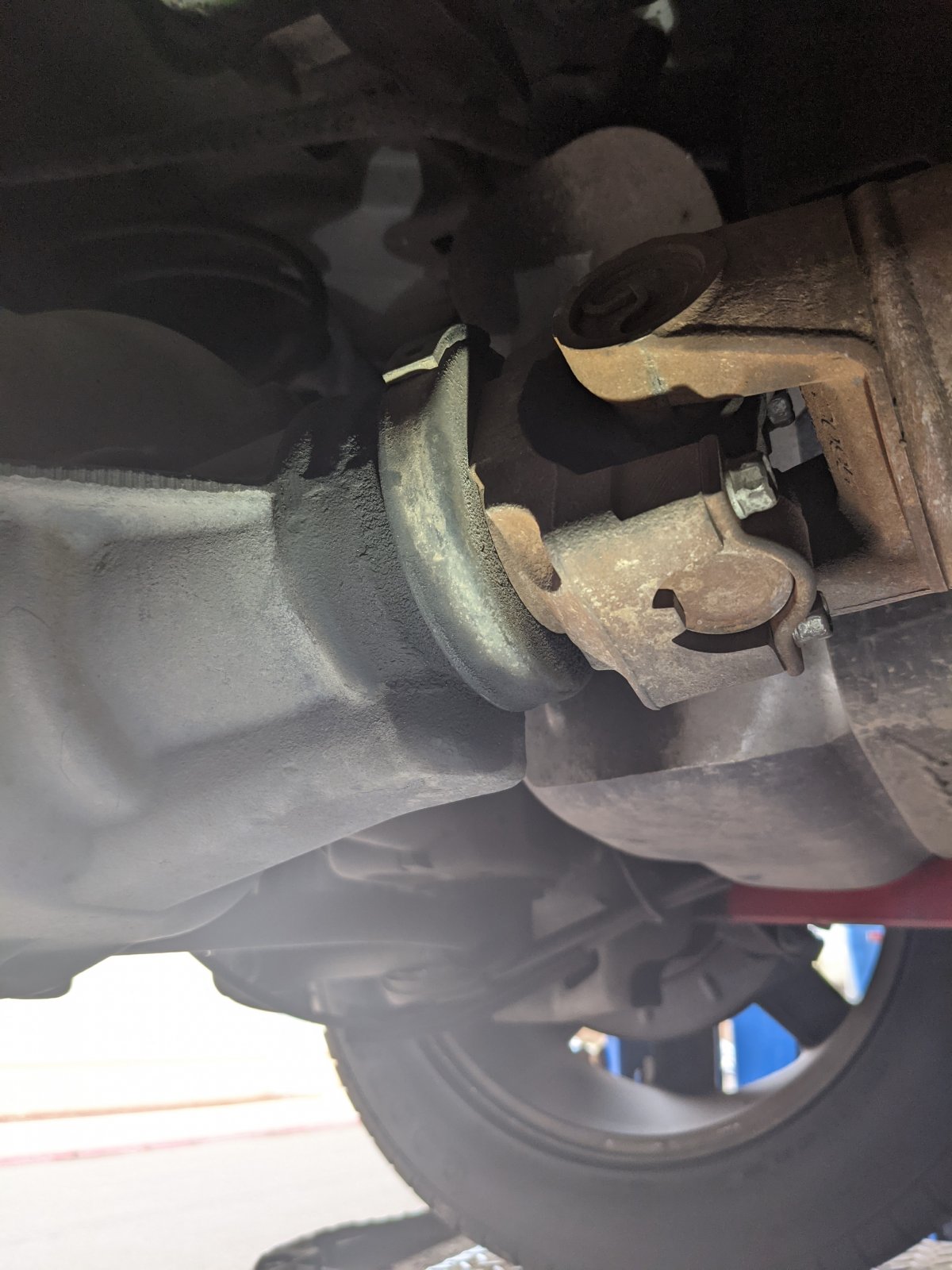

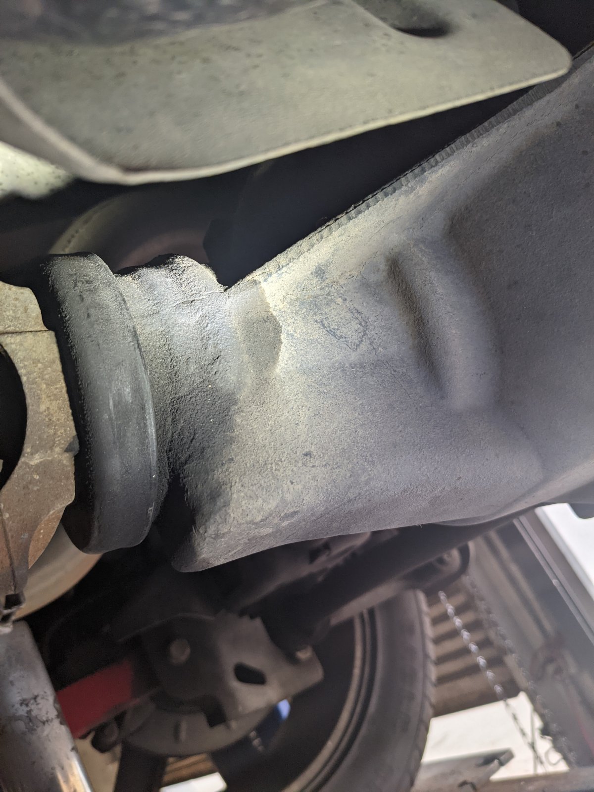

I did the rear sway bar links and bushings today. This time I preheated up the stabilizer bar bushing bolts with my Oxy-Acetylene torch and the bolt unscrewed like it was in butter. This was an easy job. I also installed the replacement bolt for yesterday's debacle with the front sway bar bushing bracket bolt that snapped. Quick Steer K6700 link (one per side) and Mevotech Supreme MK6408 bushing (set of two) all from RockAuto. Next project will be Monroe Air Shocks as I tow a 26' camper. I already have Timbren bumpers but want to raise the ass end when the trailer or camper are hooked up.
