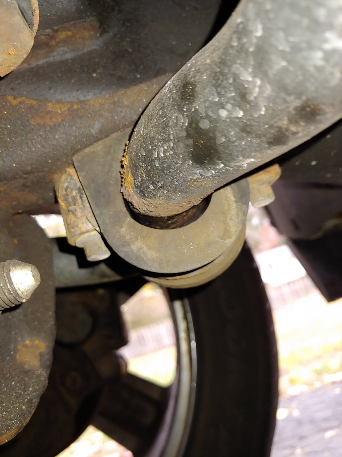

Replaced front sway bar bushings and clamps. Went with Moog for the bushings and had to go with Dorman for the clamps as that was all that was available. You can see from before pic the passenger side had a huge gap...I'm assuming these were original, 215K miles. Heads snapped off the passenger side despite soaking them in blaster for a few days prior, extracting them wasn't any fun but playing with a torch under the car was. Took impact gun to driver side and didn't have any issues with those.
View attachment 234602 View attachment 234603
I just did the same thing. Though, I never got around to the driver side. I hope they just back out l. My passenger side snapped off and needed drilled out.
New shackles and same new Moog bushings.
