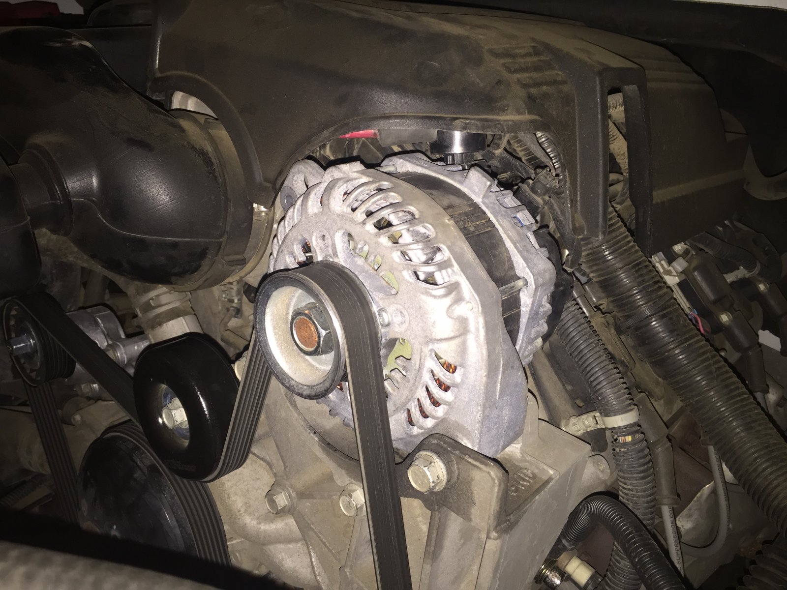

Changed out my tensioner and idler pulley. The Idler pulley I received was too small so I swapped the bearing. Both had bad bearings so I was worth it but my belt noise persisted. I believe it is the AC belt. I am looking for the threads about this issue but the search function is still down. Anyone got some links or suggestions on what belt to run?
For belts, I stick to Gates, Goodyear or Bando. They're stretch-fit, so you're gonna need the tool or take it somewhere.

Thanks. I remember you guys talking about that. Someone was gonna look into how to add a tensioner but I didn’t see any more about it. Also heard of the zit tie trick but I don’t like that much.

Makes me glad I have an '08 with the tensioner on the A/C belt.
Maybe you could buy a tensioner and bracket for an '07-'08 and bolt it onto your truck :shrug:.
