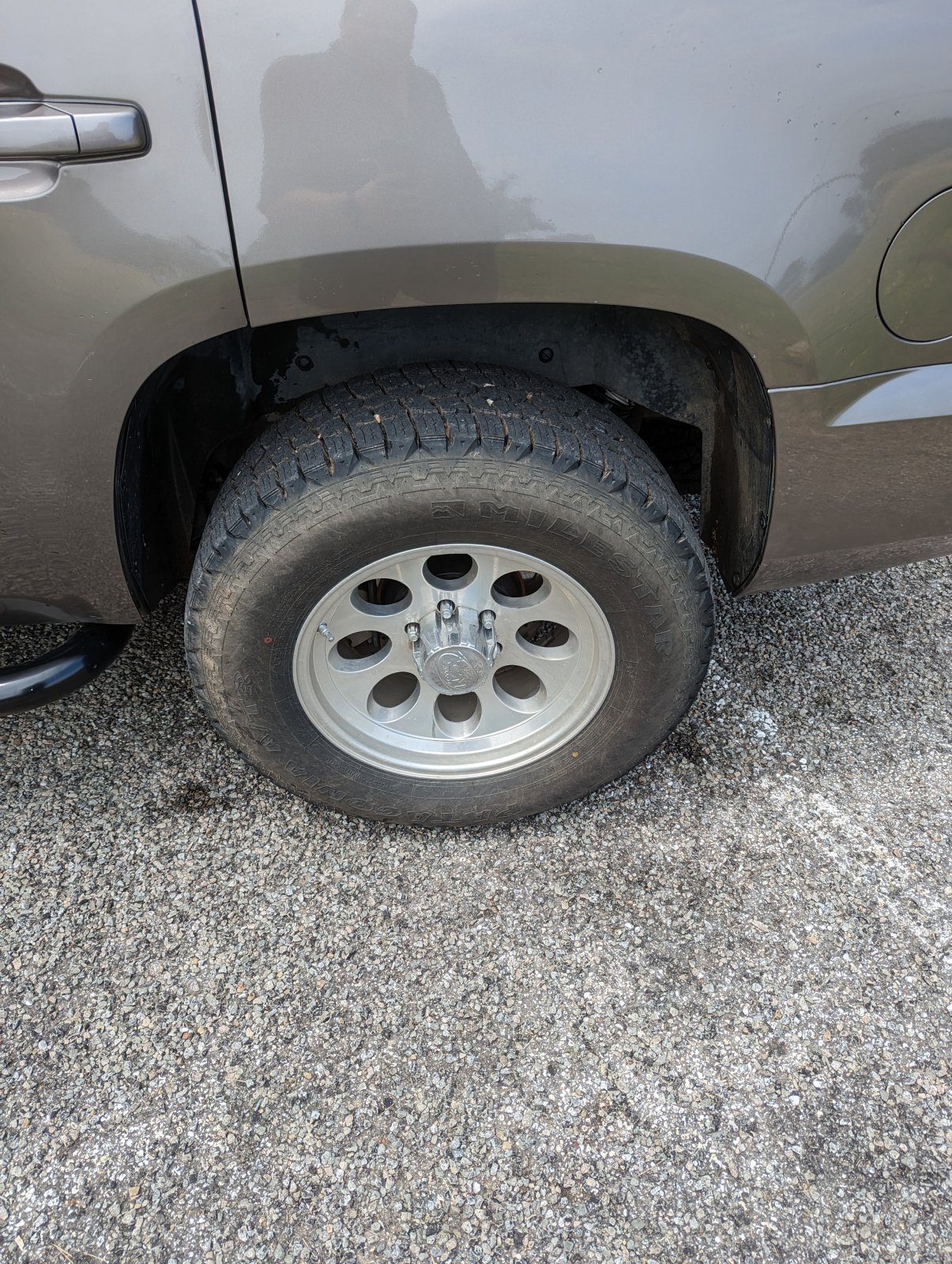

Went from this:
To THIS:
Also loaded my BBP tune! Man, what a difference. Better throttle response and the trans actually knows which gear to be in.
Black wheel nuts are still in the mail, so for now they are silver. Next up is an all black grille/ emblem and tint.
