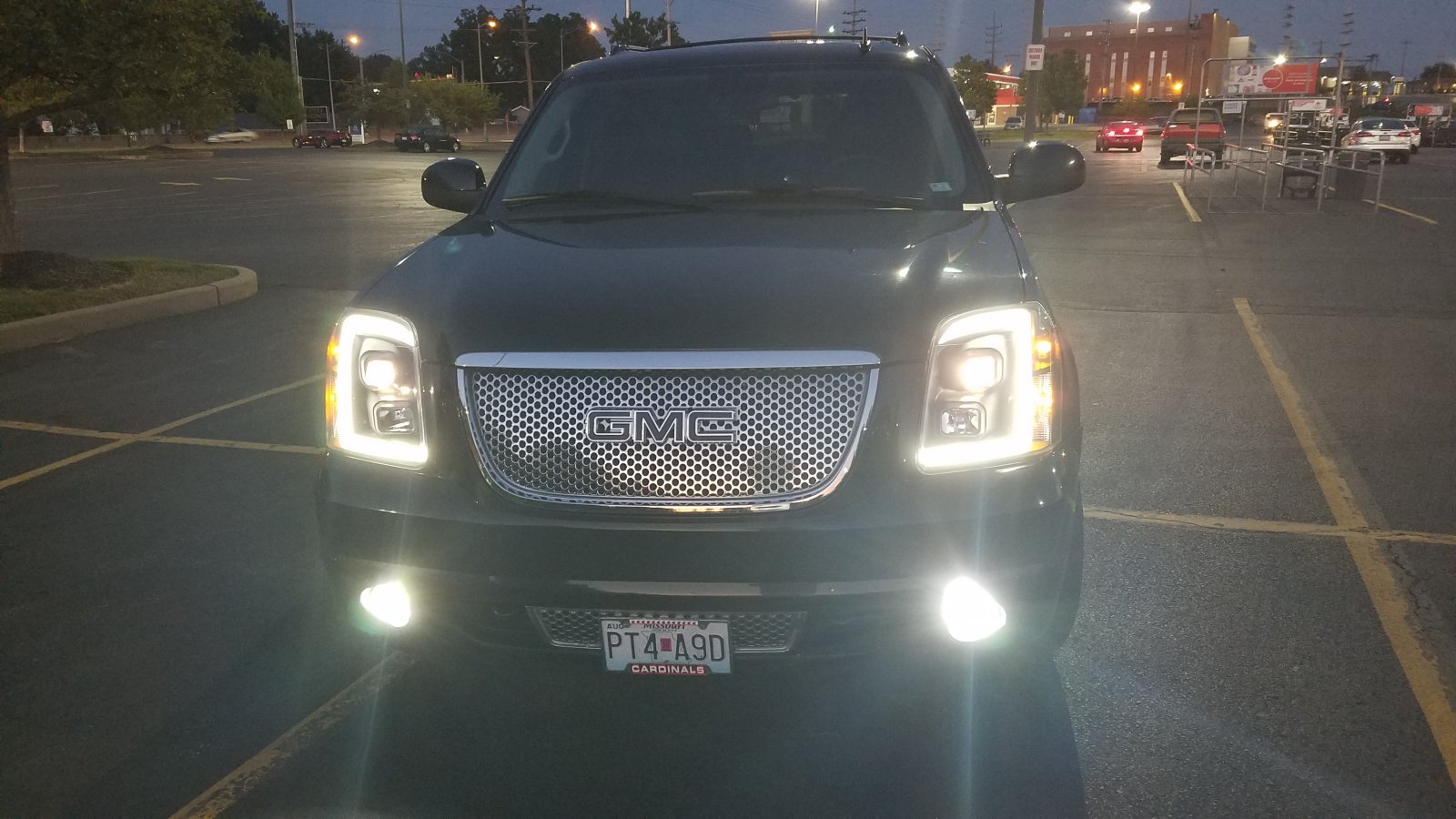

So if I want the fogs on whenever the truck is on, I still do the original mod using the low beam relay and diode, correct? The lows are always on, which will activate the fogs. Or is the diode even needed then (I leave my headlight selector on AUTO)?
Do you have a Yukon or Tahoe?
Apr 11, 2018
7,124
14,365
St. Louis
Yukon. Sorry I forgot to specify.
Well, thw original way, relay to relay, will have the fogs on basically anytime the vehicle is running, even during the day.
The diode is only used in that setup to be able to just only turn on fogs and parking lights if it's foggy and you don't want the headlights reflected back at you, or you like that look and want to be cool.
The way I posted in this thread is if you don't want the foglights on during the day with the DRLs (low beam headlights on the Yukon). I believe the Tahoe has seperate DRLs from the headlights and isn't effected by this.
