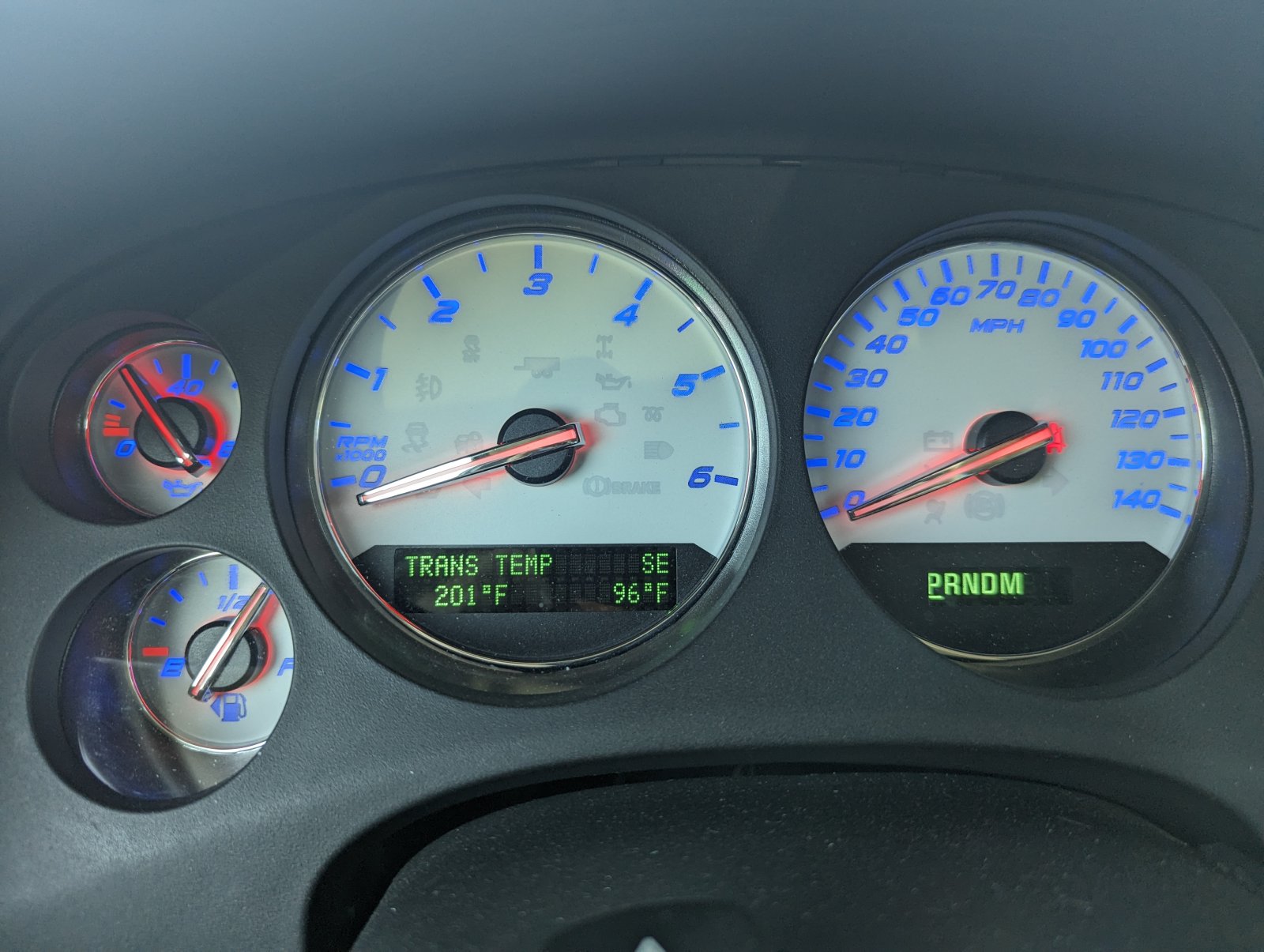

Figured I would check out my charging system since putting in the new batteries and running both grounds to the RVC a couple weeks ago, appears everything is working normal again no negative amps and the economy mode isn't kicking on when it shouldn't like it was with my old batteries, turned everything on and it has nice positive amps, I guess the batteries must have been bad even though they tested good and/or running both grounds to the RVC helps. Either way seems to be ok now, cleaned the throttle body and MAF and reset the transmission fluid life since it was just flushed and they didn't reset it, it was on 6%
