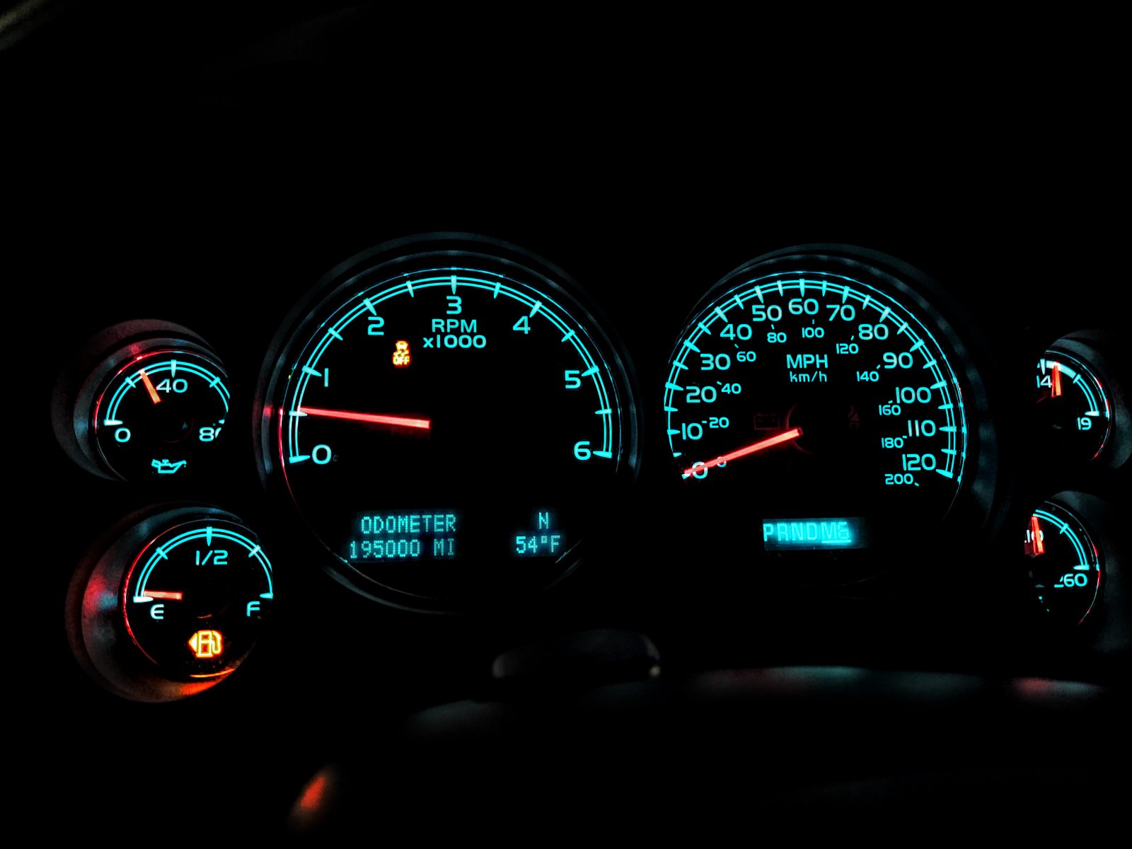

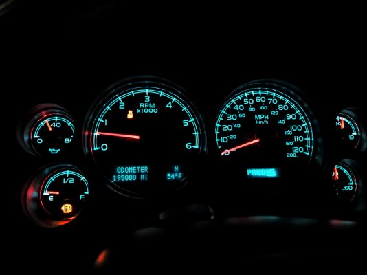

I was out a bit ago picking up Applebee's carside to go and had my Torque Pro app on and it showed my fuel pressure at 43.5 while idling.
Off topic, but my oil pressure while idling was 28-30psi
when I had mine hooked up, warmed up and idling oil pressure said 34 the one time looked at it as I was scrolling thru.
