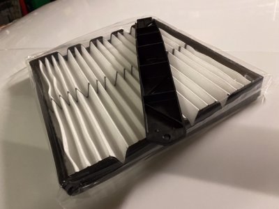

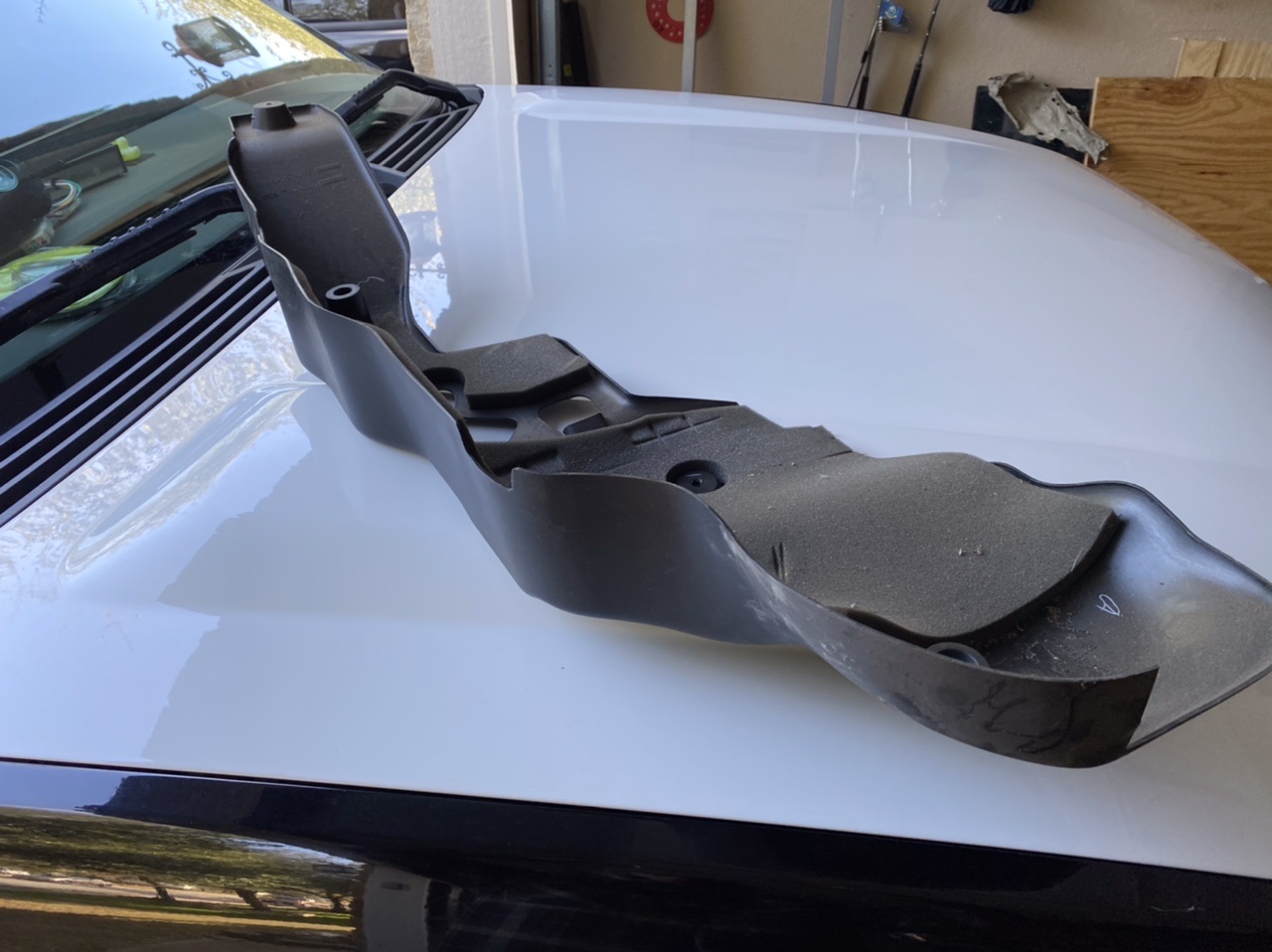

I did the cabin air filter mod to thecopcar. Getting the cover off was super easy, with the right tool.
getting the access panel cut out was a pita on the other hand.
View attachment 264867 View attachment 264868 View attachment 264869 View attachment 264870
1/4” drive air ratchet with a 7mm socket makes it easy. Just don’t even mess with the third screw on the far left, leave it off. If not that, a regular 1/4” drive ratchet works.
There were actually four screws. The one just above the transmission tunnel was inset too far for a standard socket, but not far enough to allow an extension to clear. That screw won’t go back in. It’ll either be 2 or 3.
I have a 1/4" 7mm deep well socket that's about 2 or 2.5" long that works perfect
