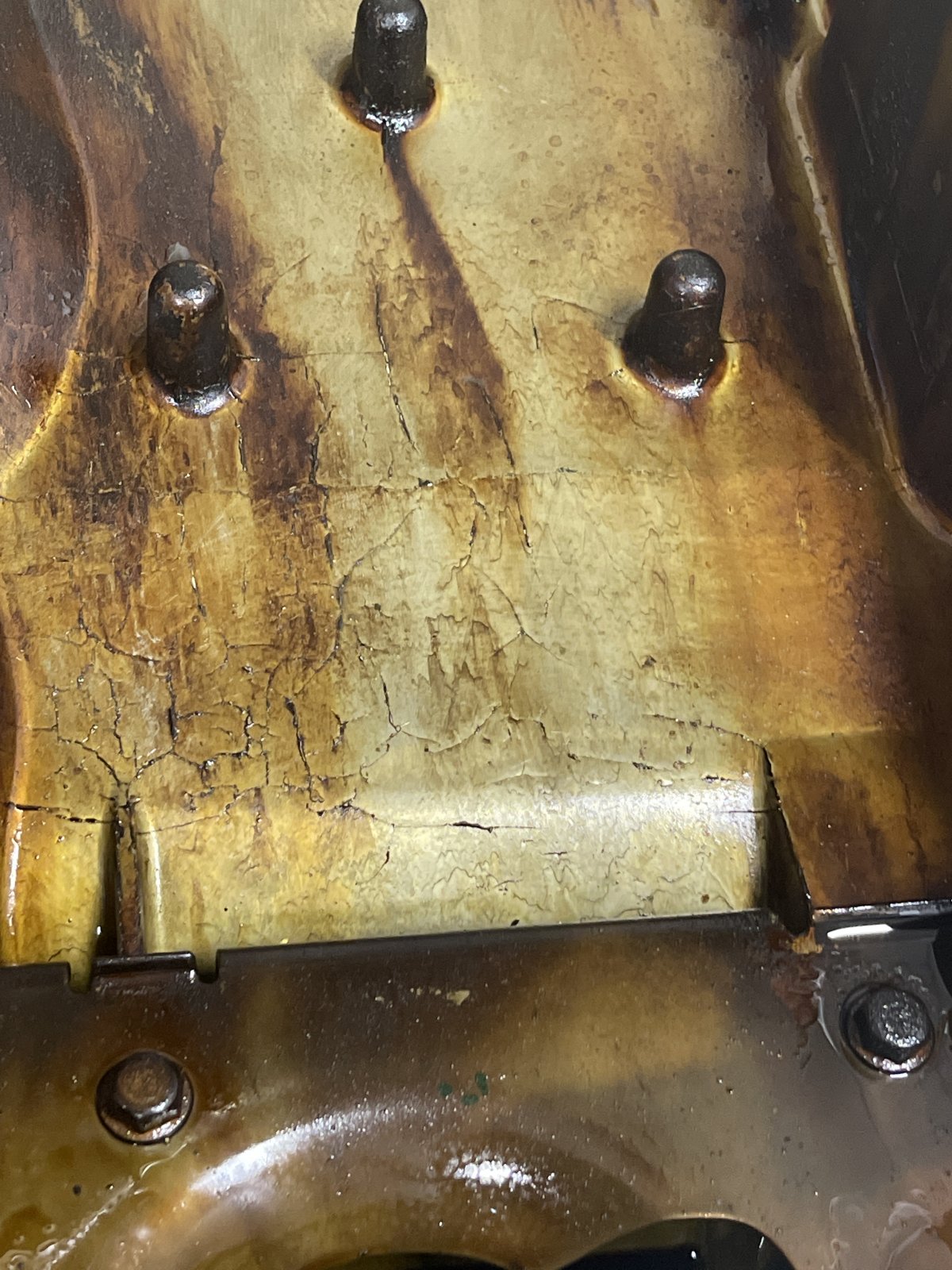

Tackled the oil pan. Not too bad of a job even with no lift. Seeing stress cracks(?) on the inside of the oil pan, wonder if I should just buy a new one.
Casting flash. Rub your hand on them and you'll feel that they are raised, like ridges. A new one would have the same. Unless they go all the way through to the outside...
