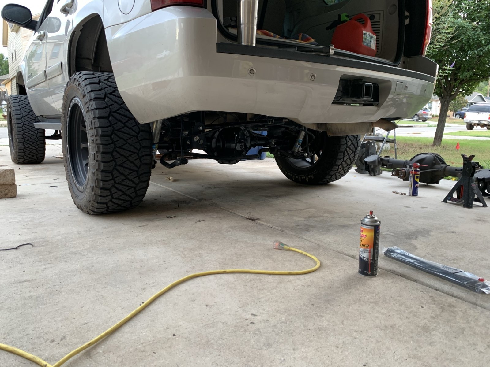

Finally installed the 14 bolt i had picked up from the junk yard a while back. My truck came with the 10 bolt and 3.42 gears. 14 bolt has 4.10's which should really help with the 33" tires.
14 bolt came from an avalanche i believe. i believe these came factory in truck with 6.2L but you'll have to search to find the gear ratio you want. Doing an axle swap is cheaper than re-gearing the existing 10 bolt and now i get the heavy duty axle. (2wd also so no front diff to re-gear either. blessing and curse)
you'll also need a conversion u-joint to a 1350 for your driveshaft. i picked up a driveshaft as well from the junkyard so i could get the new u-joints installed without any down time.
After a quick tune update with hp tuners the drive-ability is 10000x better. 4.10 is a great gear pairing for the 33's and 4l60e. seems like the 1-2 and 2-1 shift needs some cleaning up as well as idle but i've got a bit more learning to do before messing with that stuff. gear/tire wizard i can do lol

Installed a 14 bolt with 4.10's to replace my 10 bolt + 3.42s on my Tahoe today.
Didn't know that gm made 14bolts with 6lug. Sweet swap!
Awesome, I have one sitting on my work bench waiting for cooler weather! Did you really need the conversion u-joint? Mine came out of a RWD 2011 Escalade and with a cursory glance, looks the same as my original. If I understand you correctly, did yours come with 4.10 gears already?

hey james....you want one with 4.10s?
Hi Randy, think I'm going to stick with 3.42s or maybe 3.73s, still running stock size tires. Thanks for the offer, oh wait, do you mean the whole axle or gearset? My daughter and I were talking about 4.10s for her Sierra since it runs on 35s. One last question, did you need the conversion u-joint when you did your 14-bolt swap?
randeez
Sep 29, 2017
7,444
23,679
south florida
was talking about trading entire axles
i need to gear mine back down, its just as easy swapping the entire axle rather than taking it somewhere to get the ring and pinion changed
i didnt need conversion ujoint for mine, already had the 1350 joints

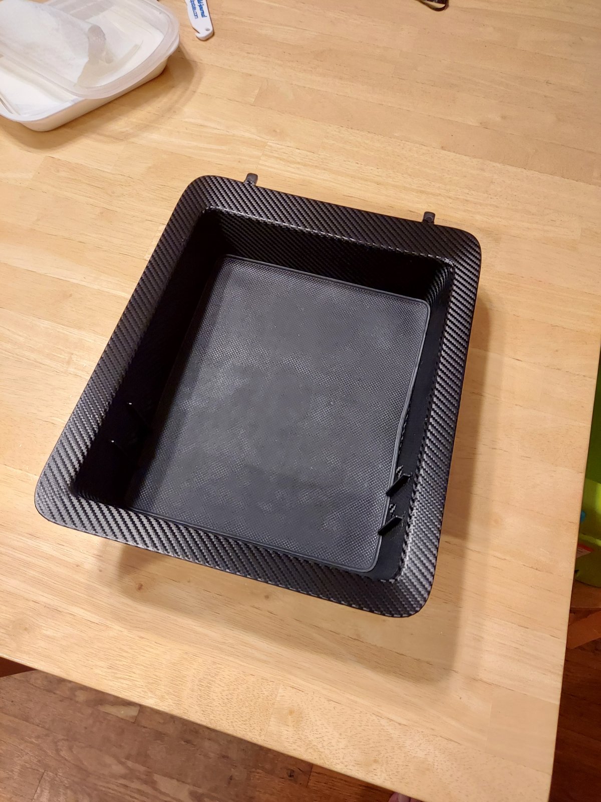

Ever since I bought it, I've been wanting to get rid of the fake wood in my Denali, by covering it with fake carbon fiber. So I did the smart thing and started with the most difficult piece; my new-to-me forward bin I scored from the junkyard out of a Suburban.
Step one was to remove the tabs for the forward cupholders, which I will never use, and fill the resulting holes.
After sanding away the parting lines and soaking it in Superclean to get rid of the funk from the previous owner, I got to work wrapping it. This took about three hours. It's not perfect. But it turned out pretty well, I think. The rubber pad is a bit distorted and still smells, so I'm on the hunt for a replacement.
It certainly has more room than the original. And no more slab of wood, or crevices that stuff can fall through.

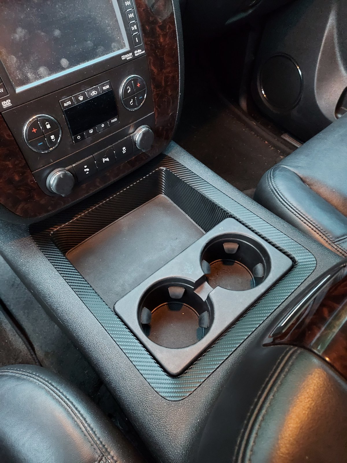

Installed in the truck, it really looks good. I've got a replacement cupholder on the way since this one is missing a tab, and has some scratches.
Now that I've started I'm looking forward to getting the rest wrapped.

Did you use 1 large piece of CF? I don't see any seams. Nice job.

I've done a bit of wrapping. Some parts are difficult but that looks pretty clean. When I wrapped my dash pieces on my NNBS Silverado I didn't really trust the areas where the wheel buttons were. When you cut a slit in the wrap for those skinny holes there isn't much material to wrap around the backside so i was afraid it wouldn't last. I ended up buying the brushed metal parts. Hopefully yours will be OK. I might have just been being paranoid or maybe I just wanted an excuse to buy all brushed metal parts.
