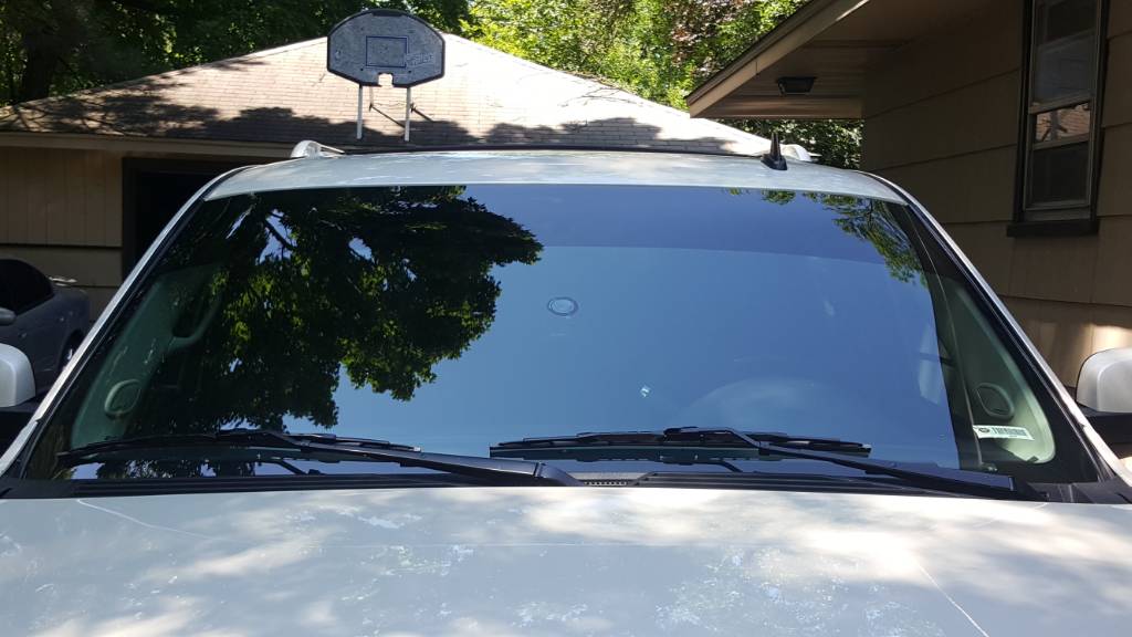

I need to do this, you use a kit?
i didn't. i cleaned the glass and the tab and used a soldering gun (not pencil). first, i coated the tab and the glass with new solder, then i placed the tab on the window and heated up the whole shebang with the soldering gun, feeding more solder into the joint, and held the gun in place until the solder cooled.
i was a bit apprehensive with the thought of heating the glass too much in one area, but it didn't get too hot overall. took about 5-10 minutes start to finish.
