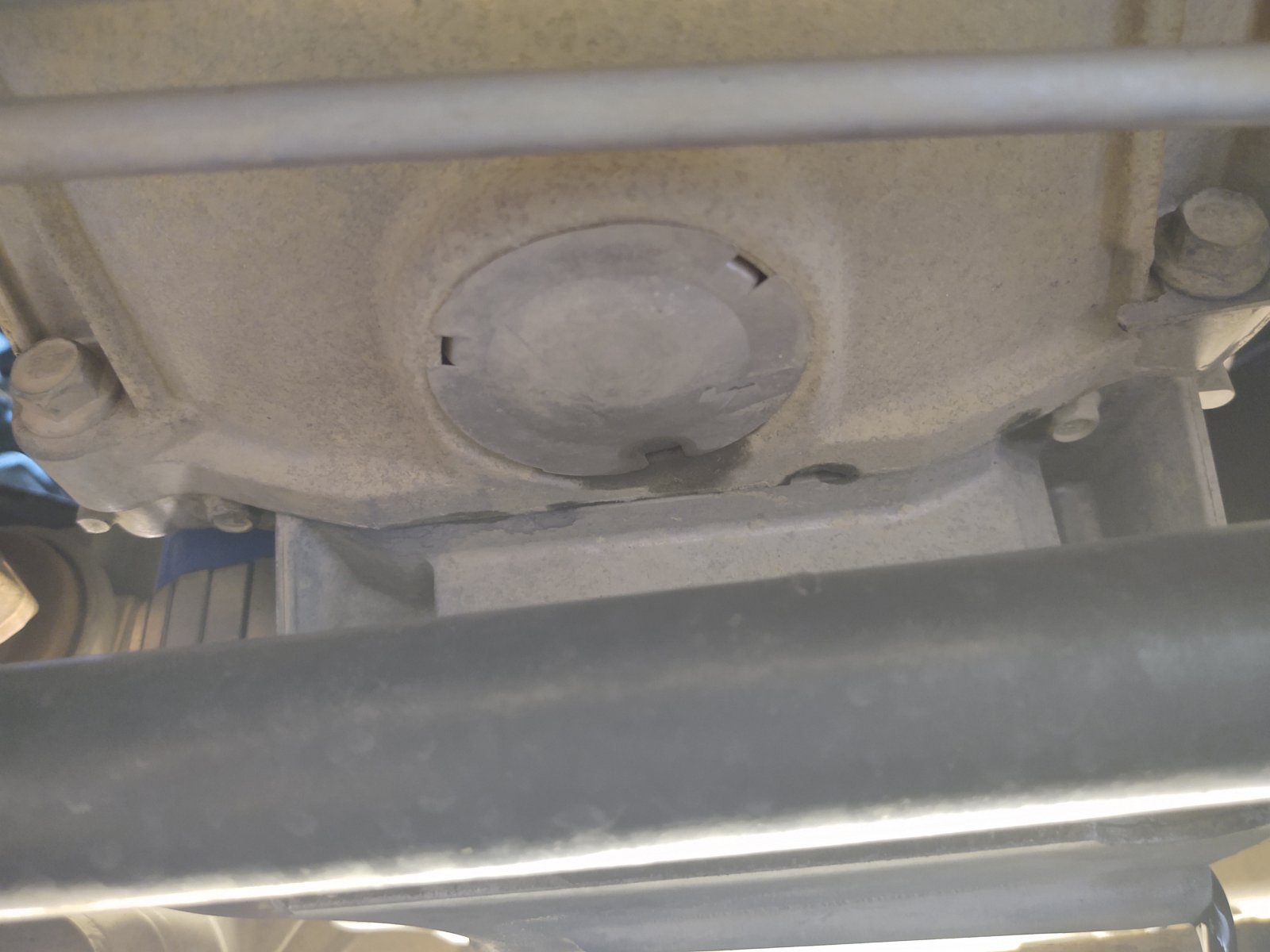

Changed the oil, looks like potentially rear main starting to weep.
Oil cooler and power steering lines are about due for a change as well.
They shouldn't be wet in the outside.
Rotating tires later.

the only thing that weeps a smidge on mine is the oil cooler lines up front where they are crimped from metal-to-rubber but I found if I just wipe them off with a rag once in a while they stay clean, I guess less oil for dust to stick on. seems to be a common place where they leak mine is so slow it's not worth the hassle. It's more of a sweat than a weep

Yeah, I've known those lines have been leaking for quite some time, but it never actually seen it wet like I did this time. But I've also never tried to wipe it off.
I don't intend to change it unless I end up pulling the engine or it gets really bad.
But I'm probably going to at least have the new hoses on hand ready to go just in case.

mine had just been replaced with brand new ones in 2017 when I bought and they had some "sweat" on them in a fairly short period so I have just chocked it up to normal.

Didn't someone show that putting a hose clamp on the crimped area helped eliminate the sweating or weep?
