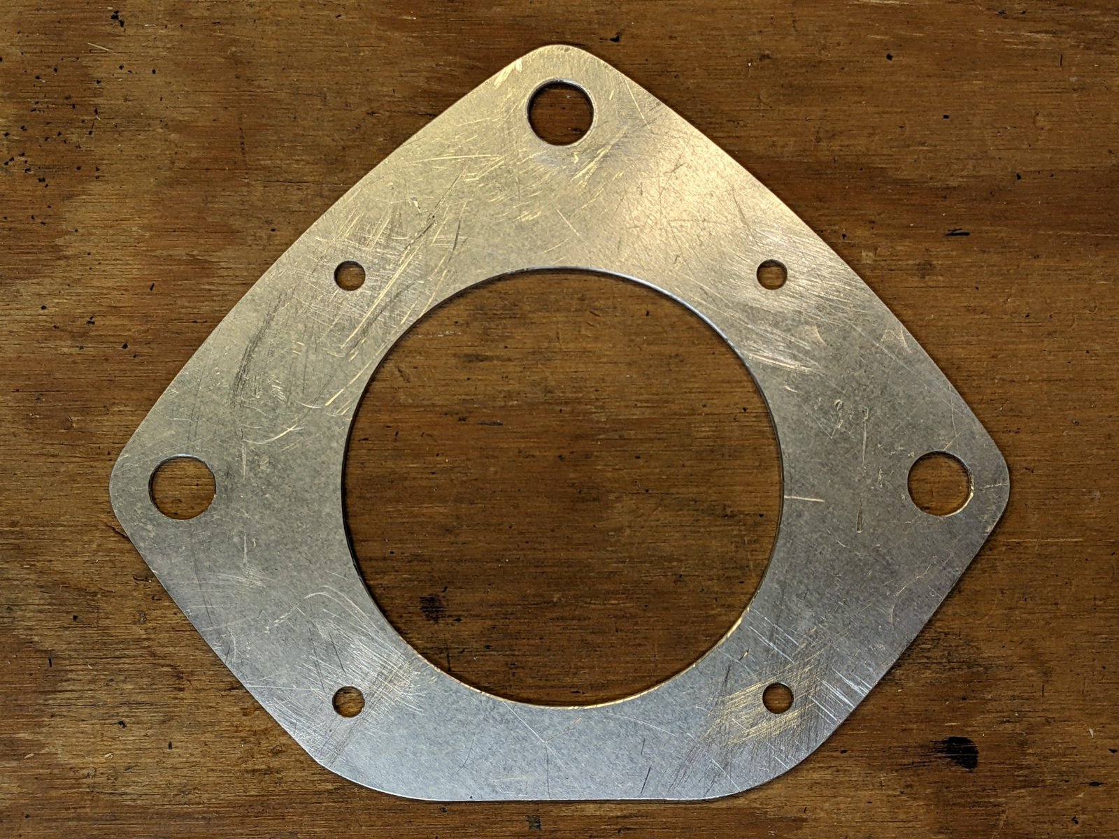

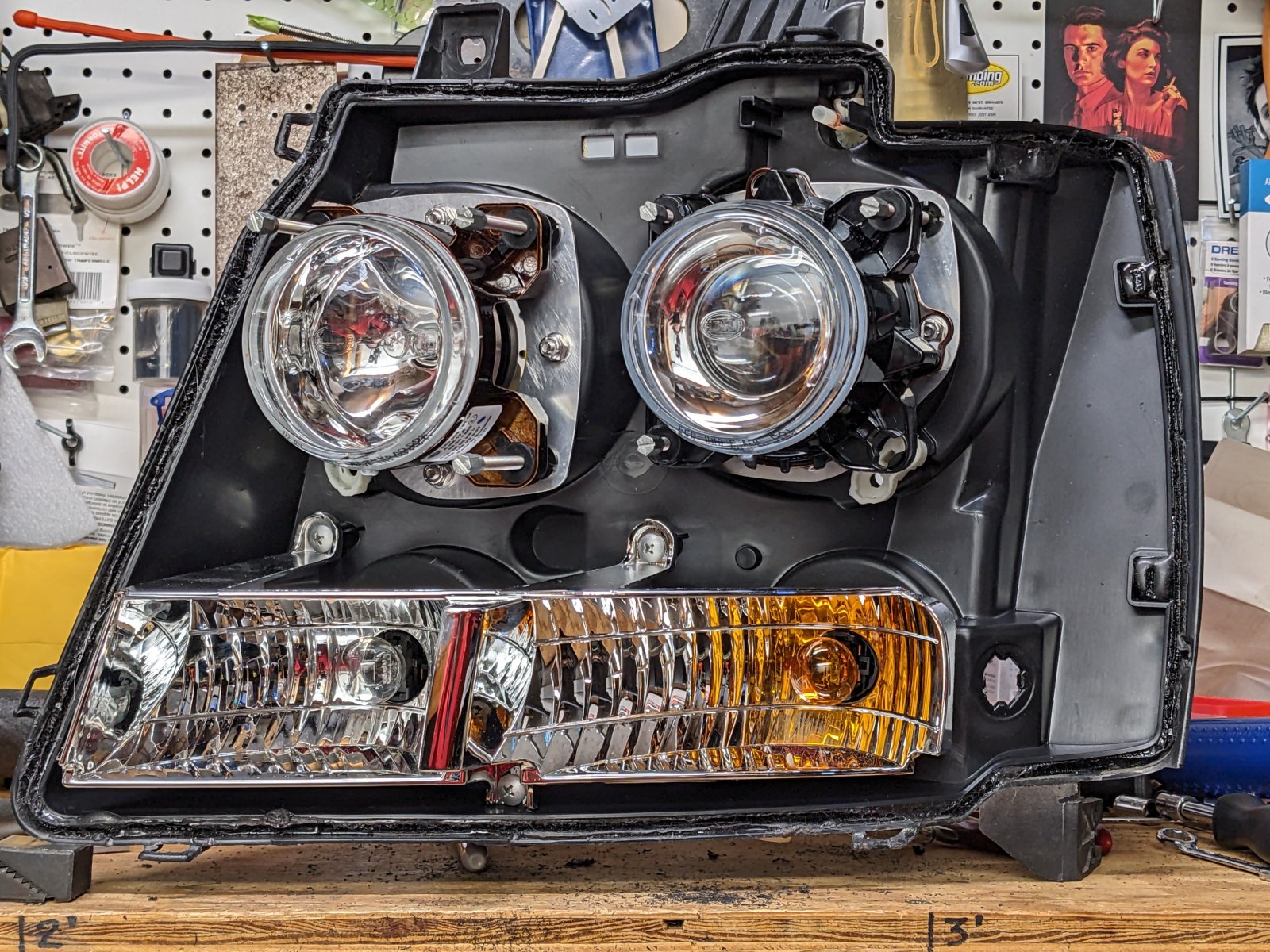

After looking at the umpteen threads about installing projectors in the stock housings, seeing all the aftermarket assemblies folks have been using, and going through my usual engineer "paralysis by analysis," I decided to try a different route. These are Hella 90mm (H9 65W) in a sacrificial Depo housing I'm only using for the protyping and testing. I'm only doing one side for now, but this should tell me what I need to know.
At this stage, I designed the mount plates so they could be used for either position, so they're not optimal for either position. There are two adjusters up top and one at the bottom, with the ones at the bottom being towards the middle, allowing individual access from the back side. I haven't figured out what I'm going to do about the lights not filling the existing bezel fully, but it'll likely be some kind of "sclera" in either polished aluminum or black.
We'll see how this works on a long drive I'll be doing soon.

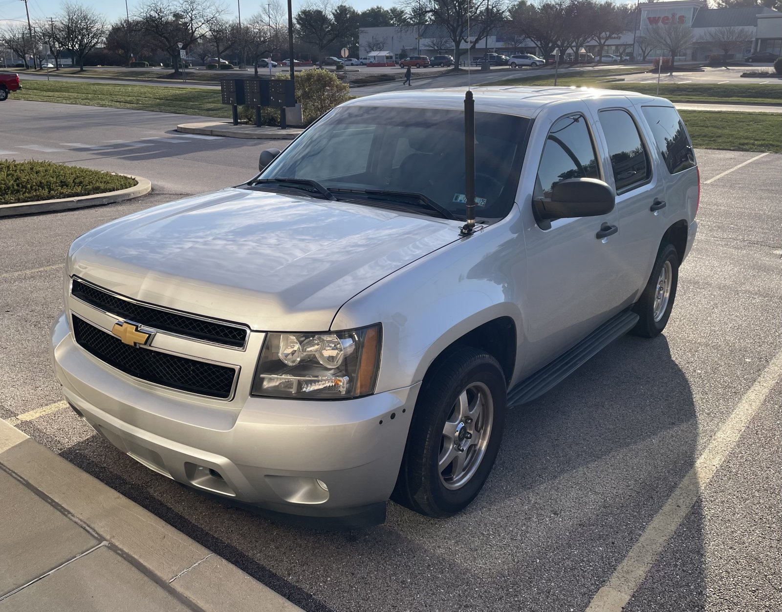

With a warm day this week, I had a chance to get the first of multiple antennas mounted on the Tahoe. This one is for HF communications, and required an extra ground strap from the mount to the inner fender to get the best results.
