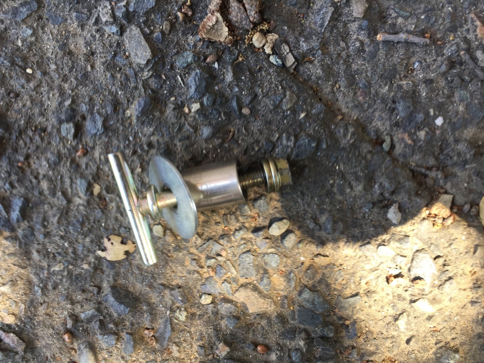

installed what is hopefully the 220amp alternator. (13536552) The wire plug and alternator cable are in slightly different spots. Alt cable was on back, now on top. Slightly larger stud, old eyelet fits perfectly though. The new wire plug has 6 slots when the old one had 4, but they line up and it snaps in like it should.
left new (20k miles), right old (200k?)
had to notch bottom of cable boot to get it up over the stud. Will hopefully get the right boot when i upgrade the cable..
engine cover sits down, just had it up for photo. only hiccup was easing one mounting bushing forward so I could slide alternator in, found the parts to make a puller..
Thanks Doubelieve for the 220amp tip! And.. thanks to the BEST forum!
