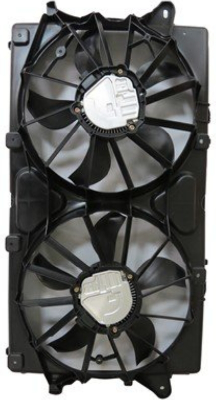

oh yeah, quick search a 2021 definitely has a brushless setup.
be interesting to see some dimensions and if it could be easily used as an upgradeView attachment 404476
if someone here with hptuners could check for the output drop down box. it might be as easy as that.
could even as the black bear guys if the tables are in the ecm already.
my 18 silverado has brushless fans I think they changed over to brushless on the K2's in 2015 but I could be wrong I haven't looked that close under hood of other's yet, that's why I was just curious if you had swapped over a shroud from a 2015+ or something with some mods as it appears that it is possible with some tweaks

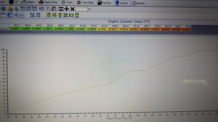

shame, I just looked again and my ecm doesn't have the option. but here's what it would look like if you have it. which you might. i have a 67A ecm. it's not used anything else. but gm usually uses the same ecm with different OS flashed into it across different platforms.
my yukon still works in % even thou it's just to turn on the 3 relays. interesting it doesn't hit 100% request till hotter than I've noticed other cars. 242*. I wonder if that has something to do with why these have 20psi caps instead of the normal 15-17psi.
ac request 100% at 371psi high side.
but being it's just relay triggers and not veritable speed, I wonder at what % it actually triggers the next step in low, med, high.
the way this is setup, makes me think the option is in there, hp just didn't define it. I should email them.

We were checking HPT at the same time. Took me a few minutes cuz I had to take the pic of my laptop screen, upload it to the laptop, then upload it to this post:
wow it looks like it's there.
"pwm electric" set to 128hz should get you a pwm output on the relay control pin. hook that to the signal wire on the brushless fan and it should work. only use the oem fans thou. say from a set off a newer truck or a car. the 0-5v square wave is inverted on the aftermarket spal fans. they can be made to work by inverting all the graphs but it's a pain and the oem version are cheap.. aftermarket same fan motor but 3 times the price.
I gotta email hp haha. I want that option haha.

since you only have high and low now, it makes sense it would be kinda high before kicking into hi.
definitely check with the scanner thou.. I've seen from 195 to 208 on scanner and dash gauge never moved. no telling what that 230 is. but it also is fine at they temp. just interesting
