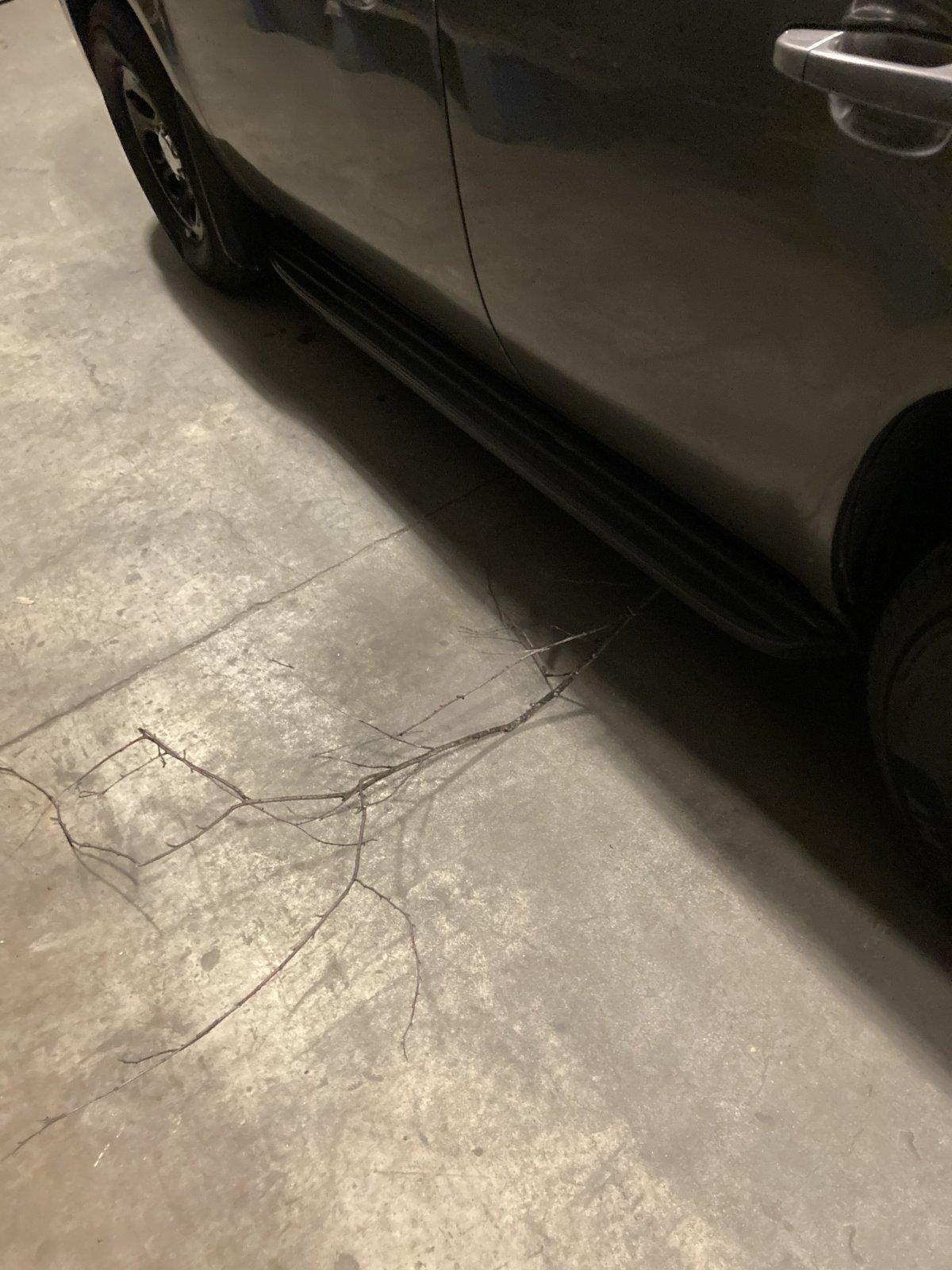

Picked up a hitchhiker. I tried yanking it out and driving over it. Refused to come out. Was afraid it was wrapped up around something important underneath. Like a fuel or brake line or wire harness,
