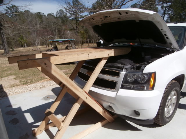

I got the rear heater core bypassed. New heater hoses on. I do not care for the quick connect system. My whole body is in pain this PM. I blew the coolant out of rear core with air. (most of it). I made up my own hoses . Used the Dorman wye which is for a later model, I was told. Made it work. Now doing a flush with soapy water, then rain water then rain water and antifreeze. Gonna use green as I like that color. I will get a pic of my motor diving scaffold I buiilt. It is ******* the body...ha ha. Will post it here tomorrow, I hope.....Pete
