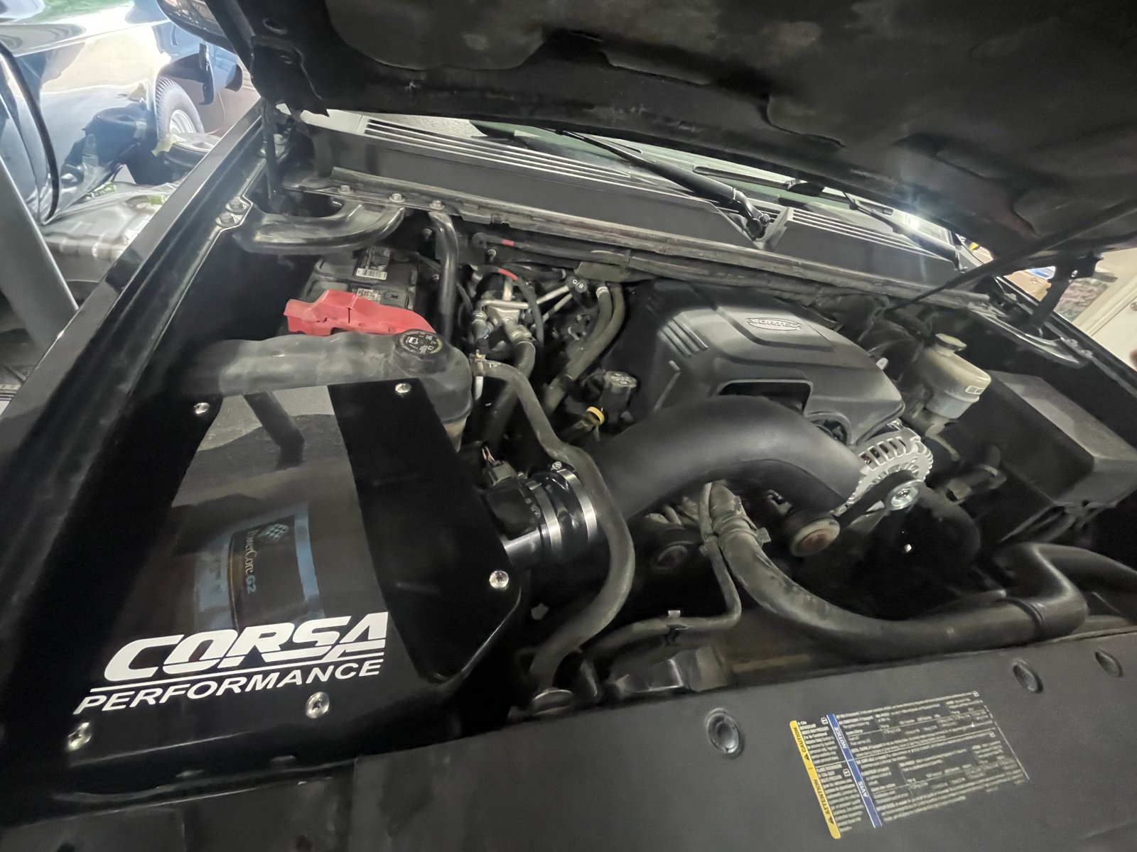

I’ve not seen the vararam intake :shrug:
The volant and this Corsa may very well be at the least very similar if not the same. I know the price is super similar. I jumped on this one because I got it at a $50 discount. I ran a Corsa intake on my ‘17, too, and liked it so knew I’d get one for my ‘09 once I had enough pennies collected. It’s a nice quality unit for sure :waytogo:
Only downside is the instructions suck pretty good but other than that I’d recommend
Did you tune it, or was your maf happy in the larger tube?
