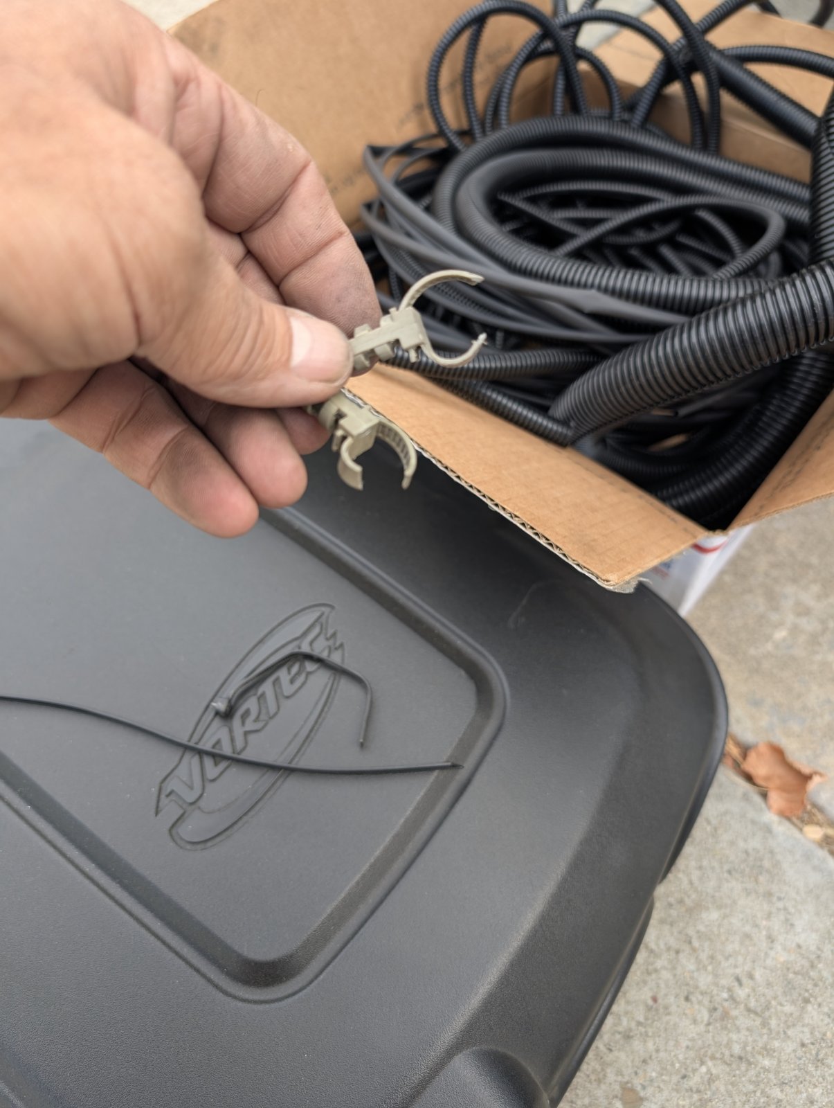

Filled the washer fluid and changed out a couple wire stand offs that were broken, salvaged a few decent ones from the junkyard, then replaced a couple sections of wire loom purchased a big box full of loom and shrink wrap for like $30-40 off of eBay a while back, these clips you can't get separate you have to buy a wire harness to get them
Try these guys for the wire loom clips.
https://www.clipsandfasteners.com/G...rt=13&cat=64&show=45&page=1&search= Wire loom
27,717
42,131
I have looked at every clip they carry before, they don't have the one that is a female mount and they don't have the S shaped clip to hold the coil pack harness to the bracket, I had one of those that broke also, I finally found one at the junkyard that worked.
almost all of my clips were brittle and crumbled when touched. I have managed to replace all the bad ones now I think. I just have keep my eyes open for them.
I still need the one that clips the oil cooler lines to the fan shroud, I just have it zip tied for now.
broken clips and leaks are a pet peeve of mine
