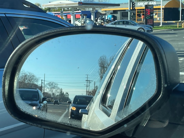

Comparison of factory driver mirror defroster vs kool vue passenger mirror. Just dew droplets, but that is how it looks with frost as well..
