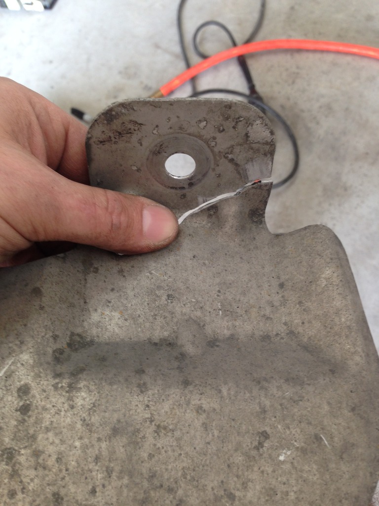

Found the source of a metallic "pinging" sound I've been hearing for a couple of weeks.
Apparently, when I bent the heat shield away for clearance when making my resonator delete, it cracked by one of the two mounting ears when I bent it back into position and eventually broke. I didn't know it was aluminum. I thought it was regular galvanized sheet metal like I'm used to seeing:

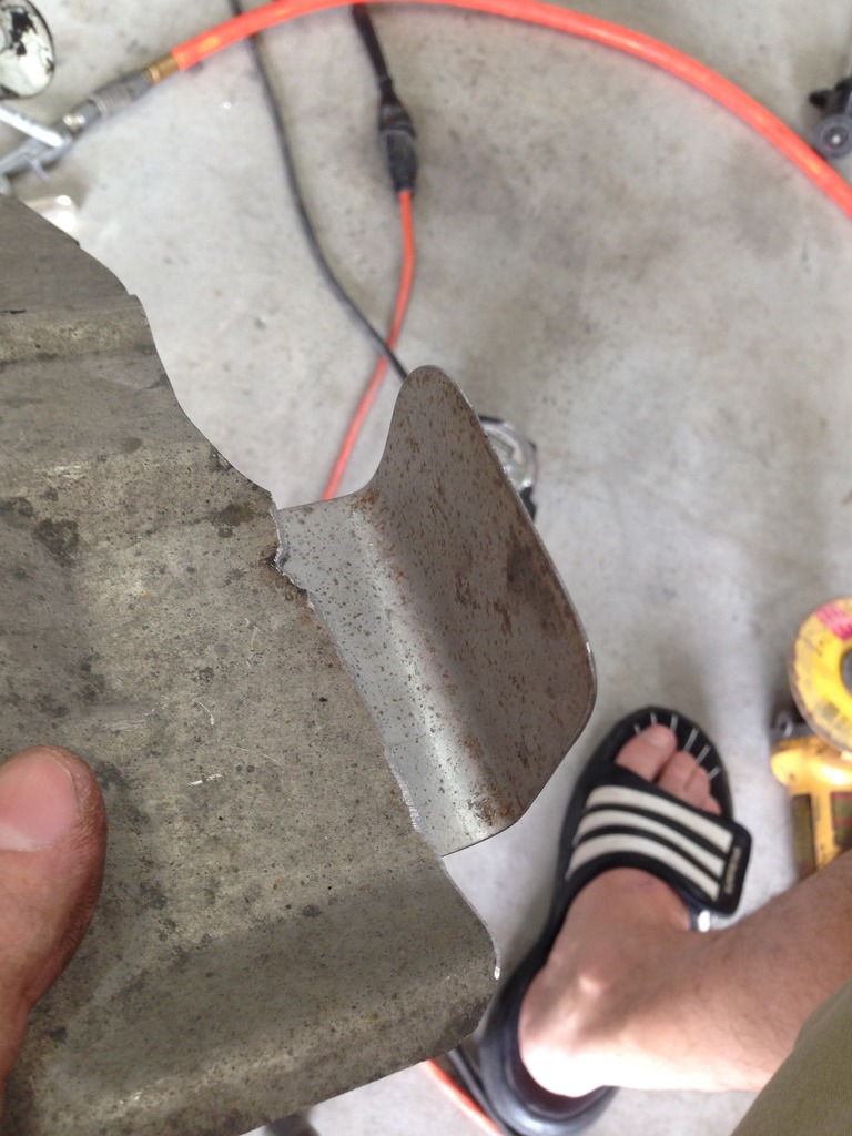

I intended to weld it back together but couldn't find the contact tips for my spool gun. Wanting it fixed today, I made a new tab with galvanized sheet metal cut from a heat shield I had in my scrap metal stock. Yes, I cut and weld metal in flip-flops:
Bolted it on, drilled a hole and spray-bombed it with aluminum-colored paint to make it look legit:
Made sure to use nothing less than grade 8.8 for structural reliability!:emotions34:
It fell right into place. You can see the fabbed ear in the background:

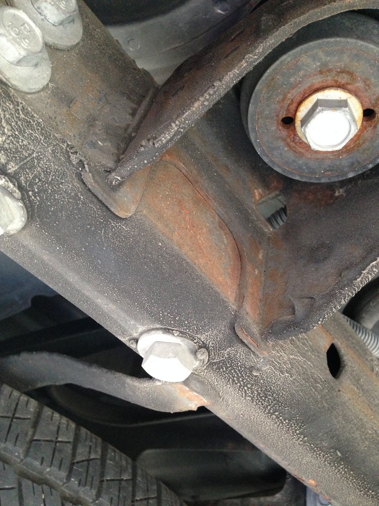

While under there, I think I found some of this "rust" stuff I hear about on these forums. I guess that's to be expected at 157,000 miles:
That's some nice quick fab work. You got some skills. Thankfully only some surface rust, but annoying nonetheless.
Thank ya!
I was gonna leave the shield off and order some contact tips, but I wanted it done because I tend to have problems finishing projects. And I was looking forward to playing with my spool gun. It's been years since I've used it.:(

Isn't the aluminum and galvanized steel going to get a bit angry being that close together?
44,971
Zinc and aluminum are very close galvanically. Also, I'm not in any environments corrosive enough to be concerned. No salted roads here and I don't live near the coast. About the best medium to induce the corrosion it'll ever see is moisture from rain or condensation from the rare times it's parked outside and even that is about the weakest conductor ever. Besides, it's just a simple heat shield. If something happens years down the road, the worst that could happen is it breaks and I my metallic pinging sound returns from the shield flapping around. By then I should have my spool gun operational.
