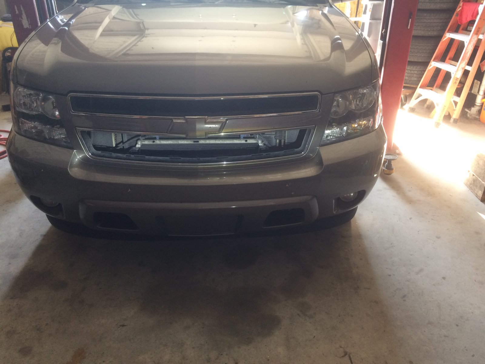

I also installed a 42" 800W curved LED light bar behind the grill and wired it up to my, previously unused (due to factory recall), heated washer fluid switch on the dash:
Here are some pics with the grill and bumper off:
In this pic ^^^ you can see the light bar and the new oil cooler on the passenger side, the bigger trans cooler is in the center.

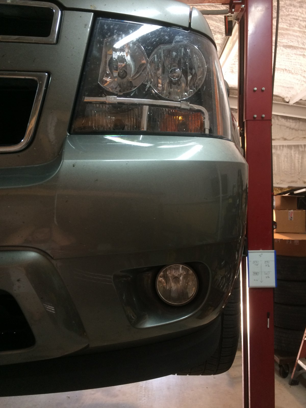

This pic ^^^ shows the clearance between the light bar and the headlights.
The curved light bar fits behind the grill without any trimming necessary.
